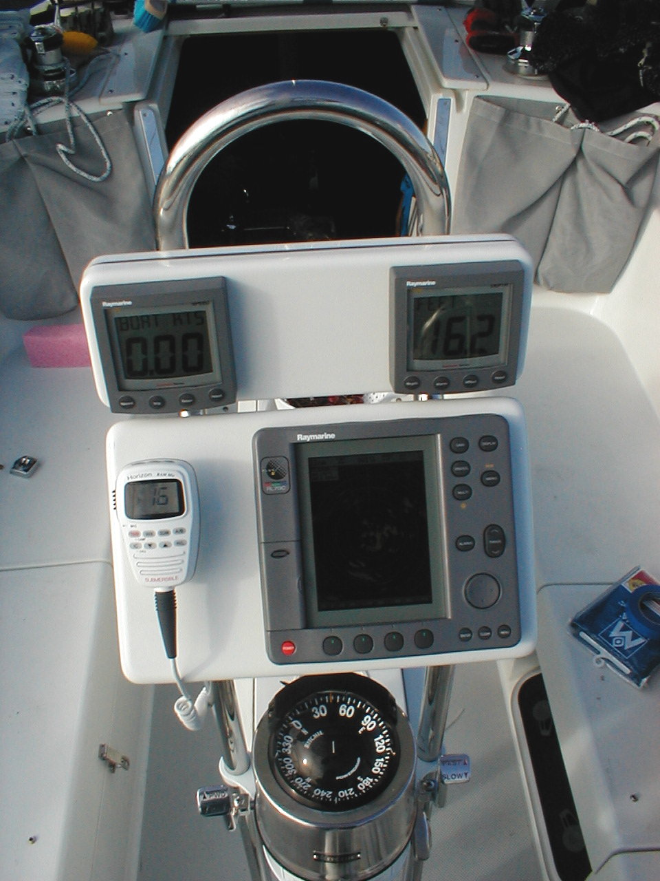

The only item you will want below at the nav station is the VHF, and all modern radios have a remote mic option that allows full control of the VHF at either station. I *Love* my Standard Horizon VHF's remote, helm-mounted "Ram Mic". It provides complete control over VHF operation, and the crispness of the speaker in that small handset is absolutely amazing.
All other stuff is best mounted at the helm. When you're trying to pilot your boat through some narrow pass or back into a marina when it is near zero-zero conditions, you will thank your lucky stars you made that decision. I have done this surprisingly often here in the Pacific Northwest, but I know that east coast weather can get pretty rotten also. Going below to look at a nav or radar display is akin to letting go of the cyclic to reach for the Jepp charts. If you don't have an autopilot, the boat will surely choose that moment to perversly exhibit a mind of its own; also, you will lose situational awareness scrambling between the two stations.
