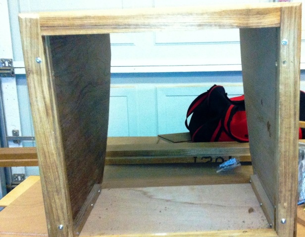

Hi,
I've a question I am in the process of building a chart table seat for my mark I. It is going to be a bench seat and I had originally planed to use it for additional storage. In looking at the area under the seat it looks like I could accomidate two additional 6 volt golf cart batteries. My question is would it make sense to add additional batteries since my intention is to take the boat cruising in the not to distant future, with the idea of having three sets of 6 volt batteries tied together. I don't know exactly what electrical needs will be at this point but I expect to be moored or on the hook most of the time since staying in marinas all the time would be cost prohibitive. Other than the additional weight I am more concerned with the distant between the sets of batteries, some where 3 to 4 feet I think. What other things would I need to consider in trying to rig something like this up and does it make sense to even consider it?
Any comment would be appreciated

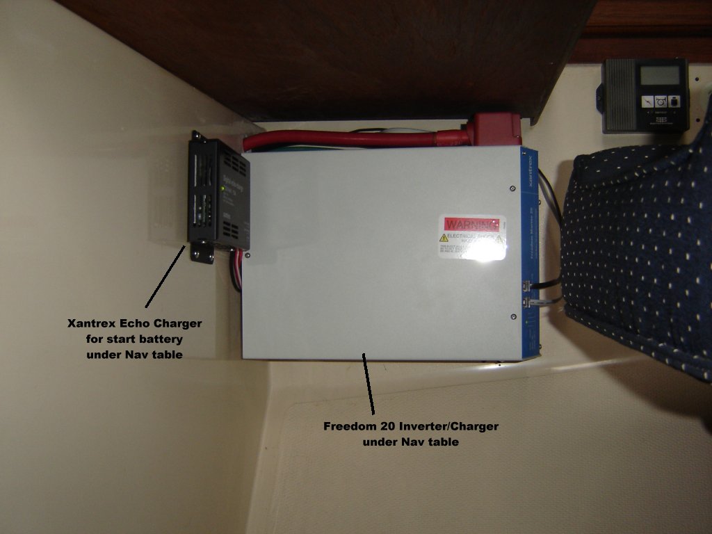

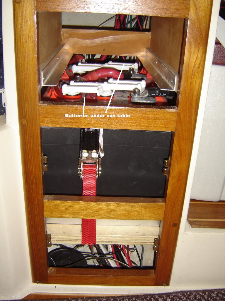

I took out the bottom two drawers in the nav station and put two 6v batteries in there. Along with the four 6V batteries under the seat in front of the nav station it gives me 696 AH of battery power for the house bank. I also installed the inverter/charger under the nav table so it is as close to the batteries as possible and I still have lots of knee room at the nav table. Hope this helps.

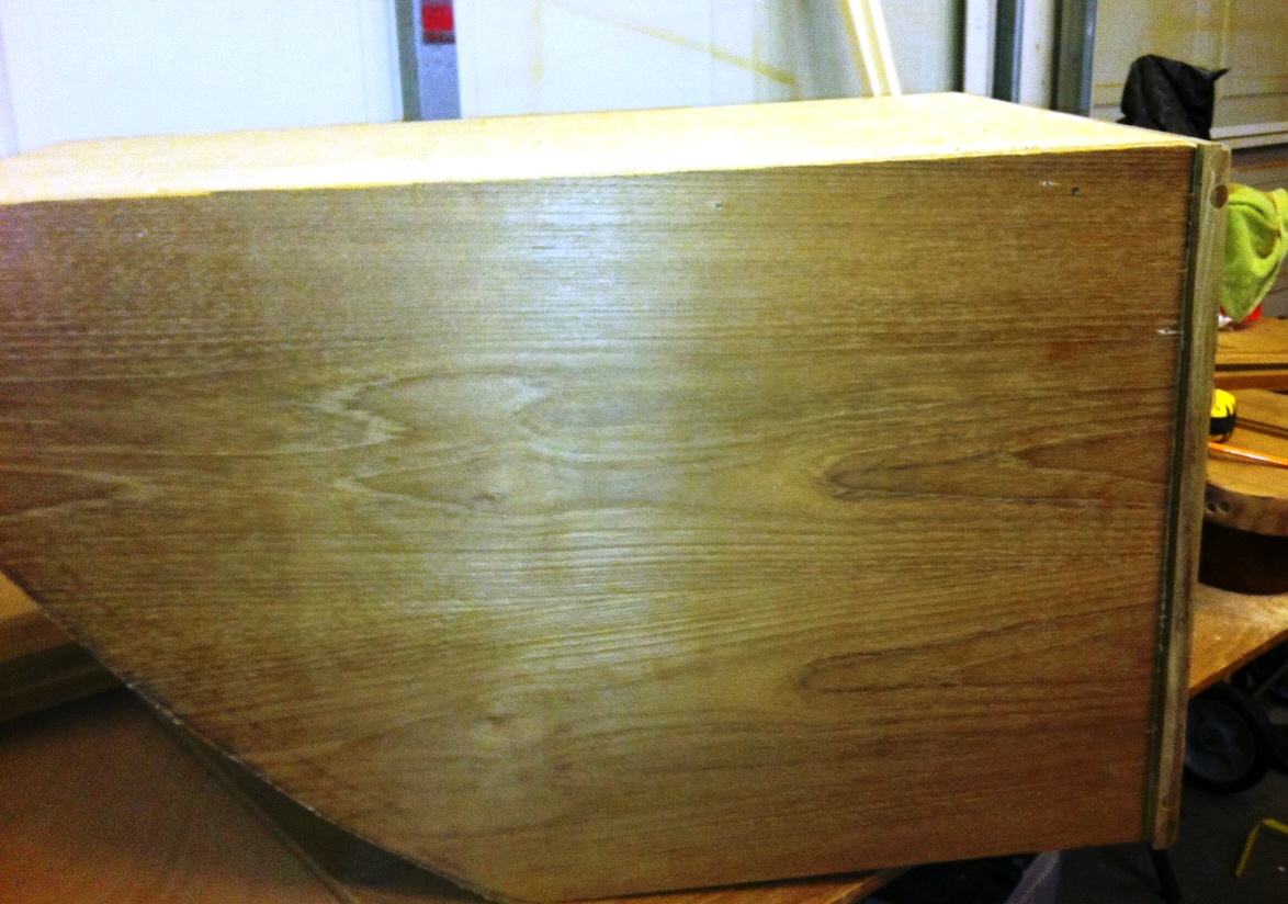

good idea Tom! only problem i have with that is i Just rebuild ALL my cabinets and frames. I would have never thought of that. I had originally thought to have some additional storage under the chart table seat I'm building but it turned out that it look like it would hold an additional bank of batteries. the attached is not the finished bench but shows the layout.

Nice Job, did you cut out the wall seperation in front to get the batteries in?
