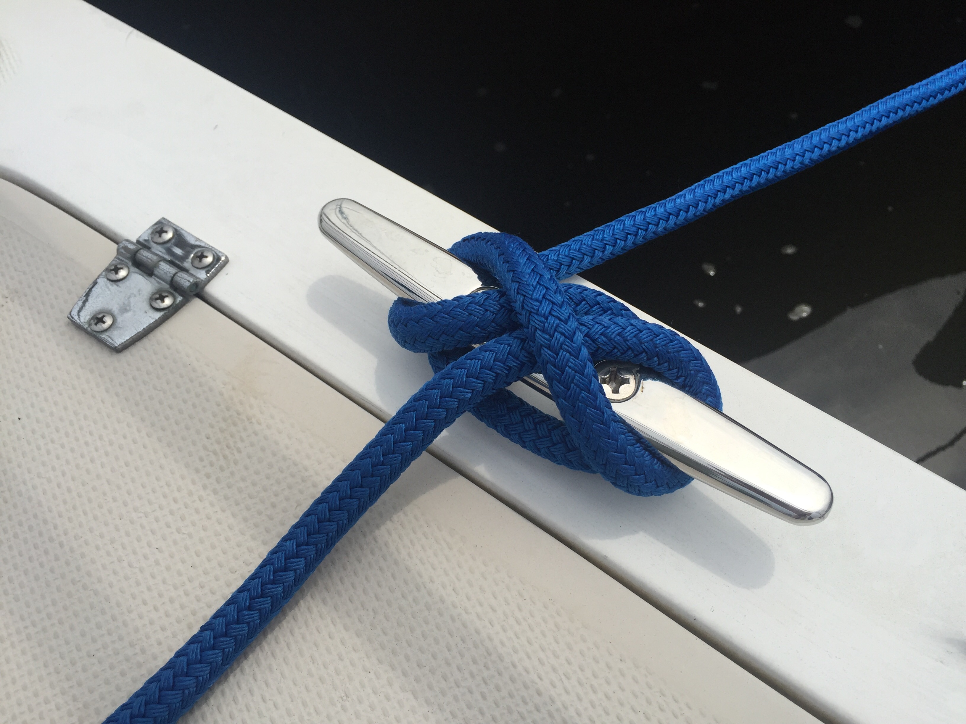

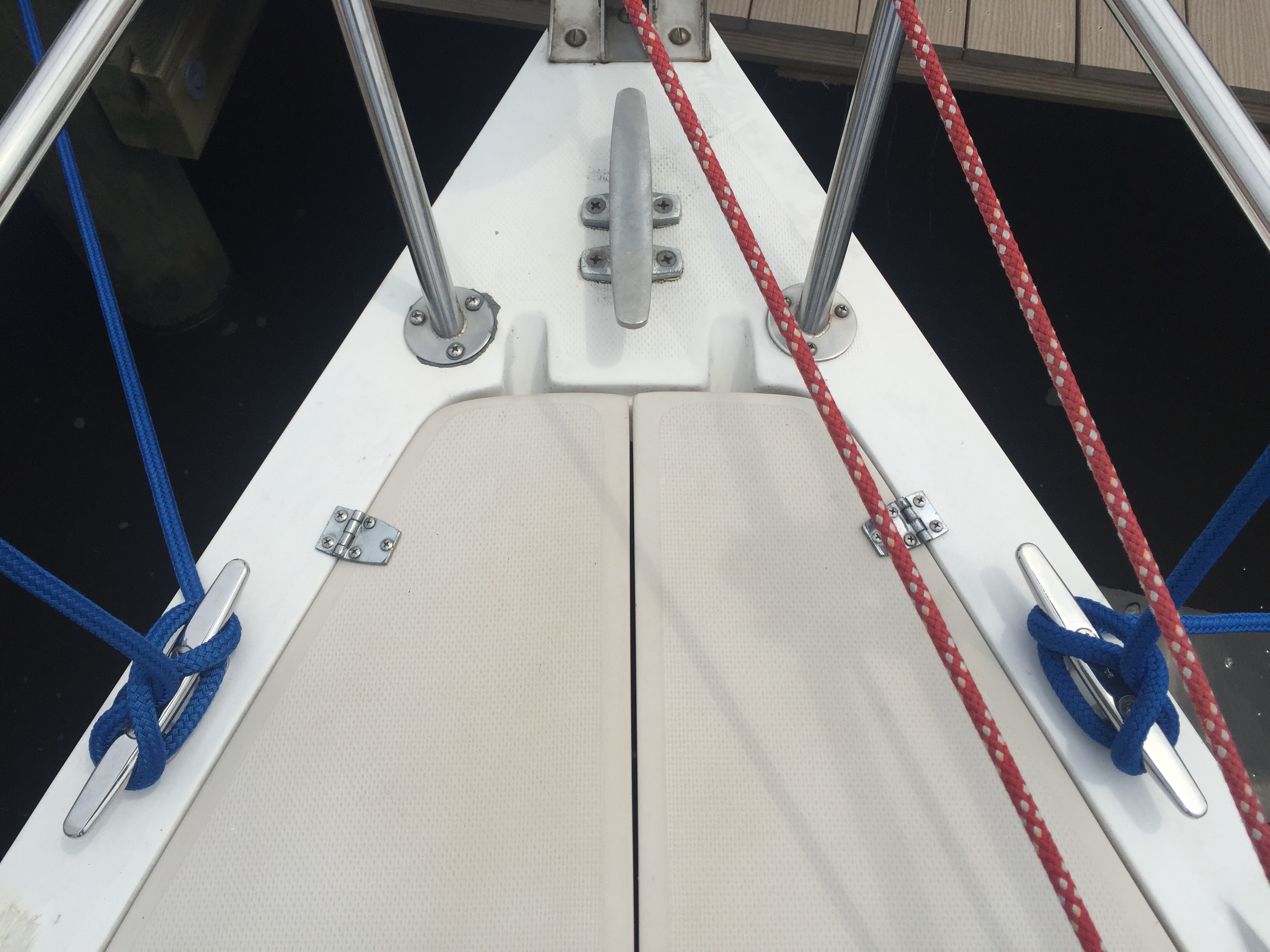

Aaron, after looking at the install more closely, I returned the Herrescoff cleats for the 2-bolt Schaefer 8" cleats for the same reasons suggested above (and I like the lines of the Schaefer better).  For a backing plate, Amazon has 1/4" x 1" x 12" SS316 bar stock for ~$8 shipped and when cut in half, is enough for both sides.  Pictured are 5/16" x 3" long screws which are 1/4" too short to engage the ESNA nuts.

Russell,
Looks NICE!
