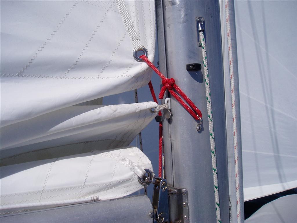

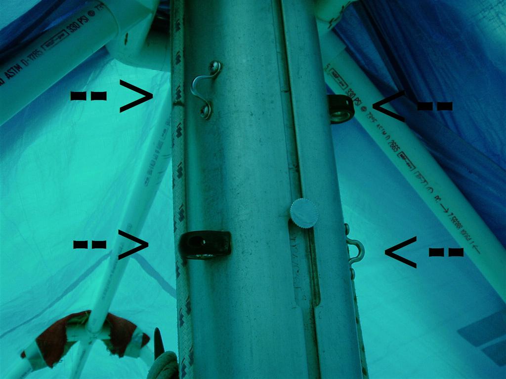

I had the same problem with Julandra (#659). During one of the first sails after I bought her, I put in the first reef for expected heavy winds. When the winds came, the two slugs above the reef ripped out, because the reefing line was only pulling the tack of the sail down. Nothing was pulling the tack of the sail forward, to counter-act the forces from the reefing line at the clew and the force of the wind on the sail. Very poor design, IMHO. After I had the sail repaired, I changed the way the forward reefing line (at the tack) was rigged. I kept the thumbscrew in place, but added a bullseye fairlead and eye strap to the mast. With the reefing line tied to the eye strap, up through the cringle, and down thru the fairlead, the tack of the sail was now pulled down AND forward, at roughly a 45 degree angle. It worked well for the next 17 years in all sorts of conditions. I assume it is still working well for the new owner. The fact that the sail is slightly bunched up just above the thumbscrew didn't matter at all. The sail shape was flat and tight. I've attached a pic showing the fairlead and eye strap installed for both the first and second reef. The first reef line comes down on the port side, the second reef line comes down on the stbd side. Sorry about the blue color. The pic was taken under a winter tarp. The second pic shows the first reef in place, sailing in 20-22 kts apparent. The reefing line could be tightened a bit more (down to the knot?), but it was working well, as the luff of the main is parallel to the mast, and no slugs are being ripped off. The second reefing line is not rigged in this pic. Hope this helps.
