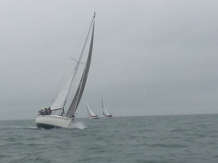

Posts: 429
[IMG]http://www.c36ia.com/forums/attachment.php?attachmentid=1578&stc=1&d=138...
This was taken this weekend from a J/29 which we subsequently out-pointed. By the end of this tack we were in the same relative position on their windward side.
All I can say from looking at it is that we are carrying the boom really high - looks like almost a foot to weather of centerline.
The main sheet is not that tight - the top of the sail is open but the bottom has that hook to weather. I think that's the trick.
