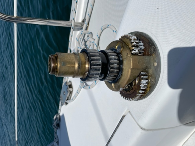

Posts: 720
Just putting a plug in for winch maintenance. It's been one of those chores I've always put off and now the years have added up. Similar to some comments in the below threads- its really not a bad job, especially with the Lewmar winches.                   The top chrome cap is removed by placing a screw driver or wood dowel in the indents and lightly tapping at an angle to start the unscrewing process. Once the cap is removed, there are three Phillips screws that secure the black rope clutch disc.  After that, no tools are needed for complete disassembly. The crank shaft pulls up and out after two keys are removed. Bearings, spacers slide off after that. The gears slide out horizontally after their pins are lifted out. Inside the gears are the pawls. If removed, there is a little spring that will need to be oriented correctly when the pawl is reassembled. Clean the old grease and replace with new (lithium based winch grease). Grease the gears and bearings. Oil the pawls (Grease may inhibit their function, especially as it ages). Attached is a picture of the internal workings after the rope clutch, chrome drum, top cap and crank shaft have been removed.
When reassembling, stick your fingers inside the crank shaft and lift it slightly so the two keys can be readily put in place. That little trick took me about an hour of frustration to figure out.
Ours had never been cleaned/ re-greased since new (unless the PO did it) and the grease had dried to the point that it resembled wax. It had to be scraped off for removal and that took about an hour per winch.
