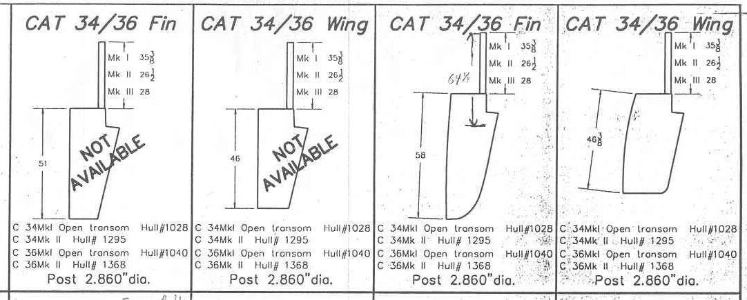

To compliment what Tom Soko said, hull #1368 was the first MKII and hull #1040 had the first walk through transom, at least according to the attached drawing of the diffrent rudder types.
