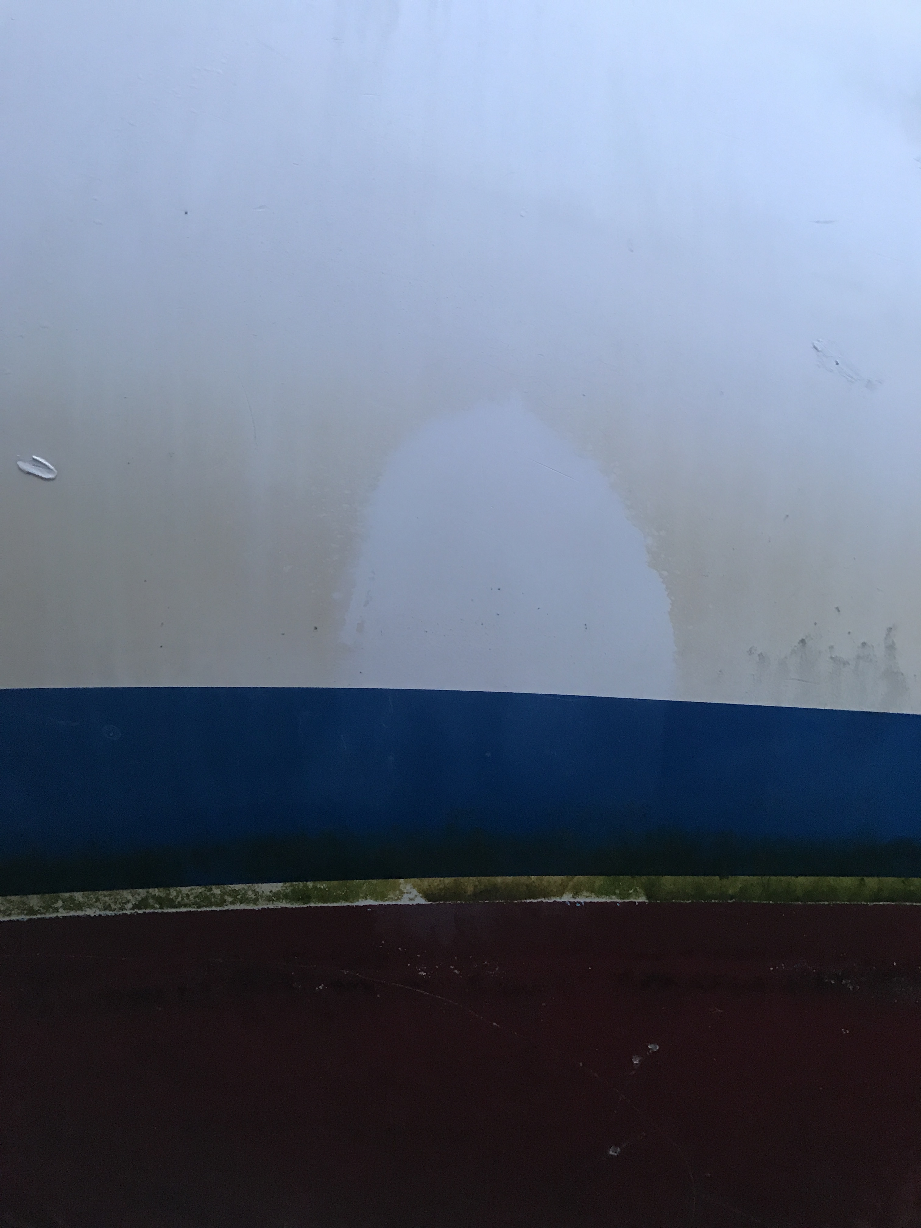

I picked up some RustAid at Lowes which I think is made by GoofOff and a super bargain at $10 a gallon.  It worked amazing and I didn't seem to have to scrub it, just put it in a spray bottle and then spread it out with a deck brush then hosed it off.   Attaching a photo of my test spot, sprayed it on then 10 minutes later hosed it off.
I tried the FSR and it just seemed like I had to really work at it to make a difference.
