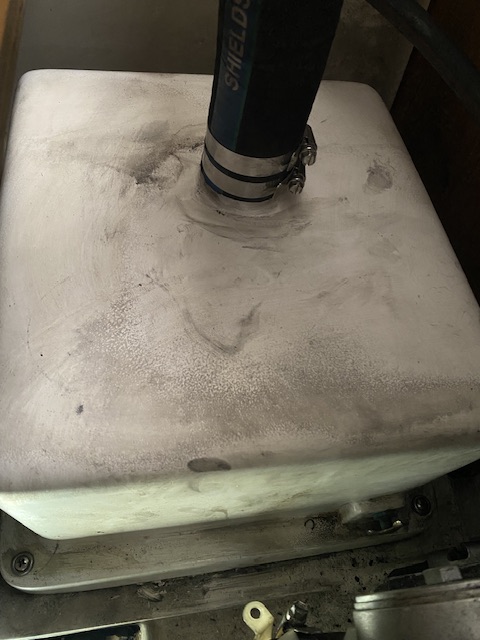

Has anybody ever had to replace their water muffler that sits on the port side behind the engine? It's approximately a 14 in.² box with a fabricated metal hose system that feeds water from the engine through it. Mine happens to be leaking and I'm not sure where to find one. Any thoughts? Take care, Rich.

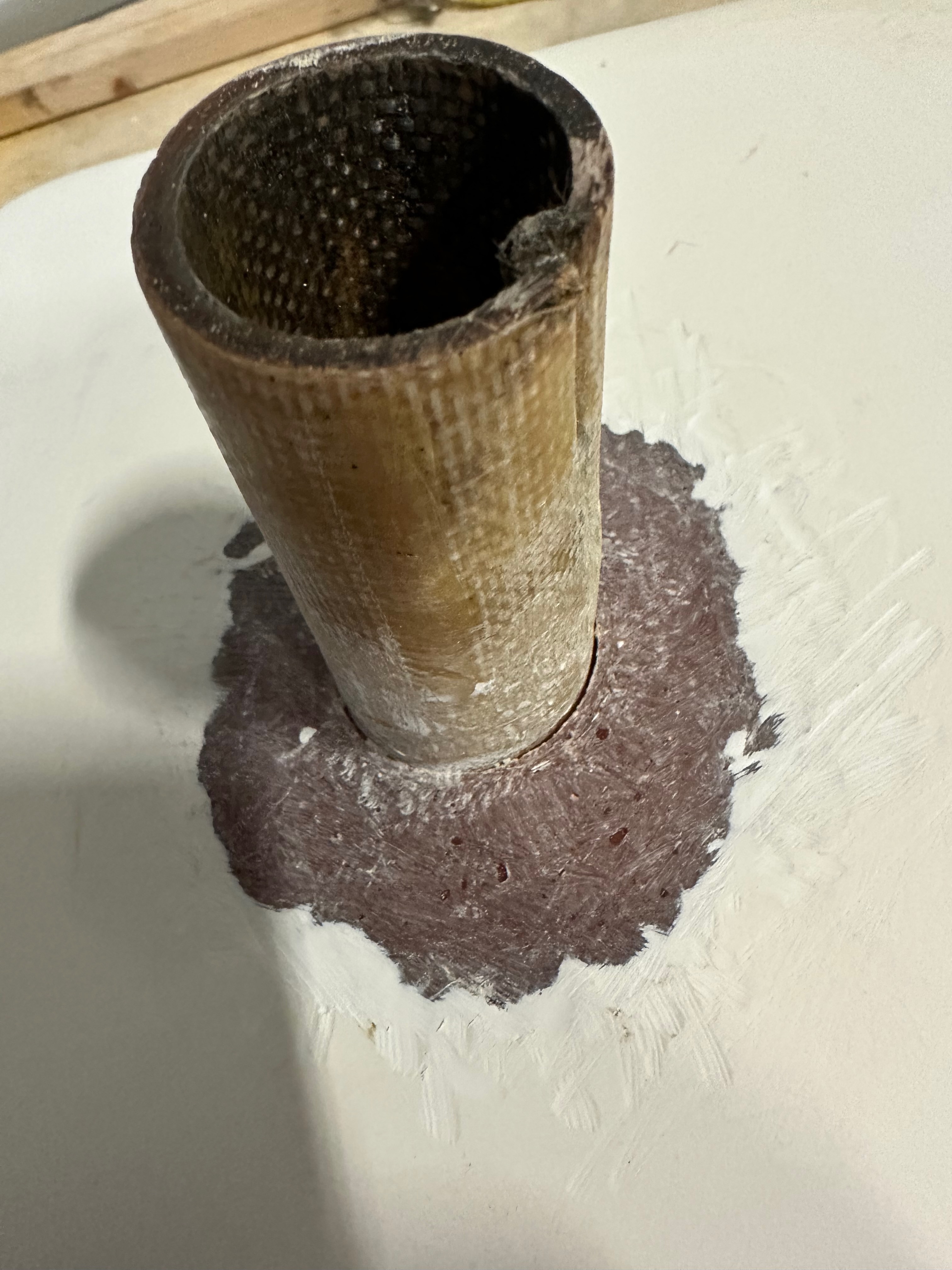

We had similar problem and after removing and proper cleaning the "mickey-mouse quality" was clearly visible. We made a proper repair with GRP-epoxy on the inlet and also we attacked the bottom part, which we actually filled with epoxy till a flush bottom. Not a complicated repair and now all is repaired.

I fixed my leaking water muffler with high temperature resistant JB weld.  Going on 4 years...there is another similar post on this forum with detailed repair procedure and pictures.
