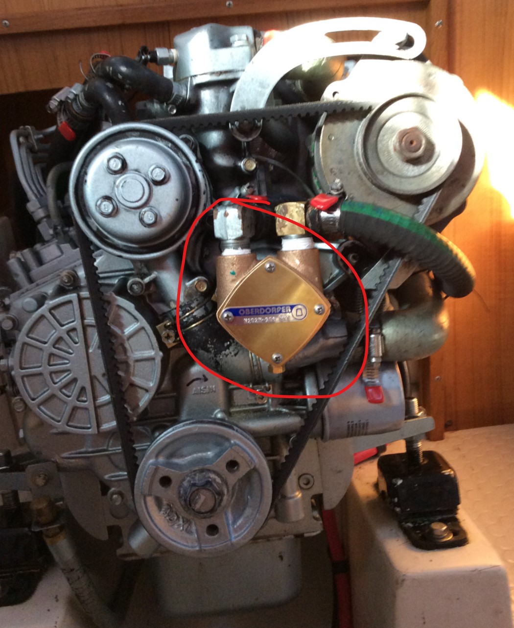

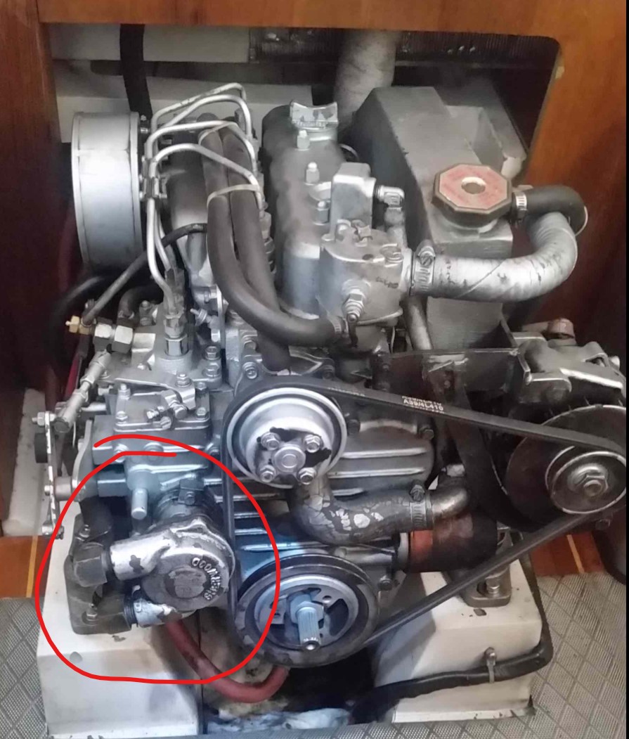

The quick way is to note where your raw water pump is located.  If it is off to the starboard side of the engine, it's an M35A.  If it's in the center of the engine, it's an M35B.

The pictures help a lot, thank you! I have the A model then.

I had the same question about the A vs B models, and the photos solved it, thank you very much. One difference is that the replacement 110 A alternators sold by Catalina Direct will not work on the B model. Note that the adjustable arm is underneath the alternator on the A model, and  above it on the B model.
