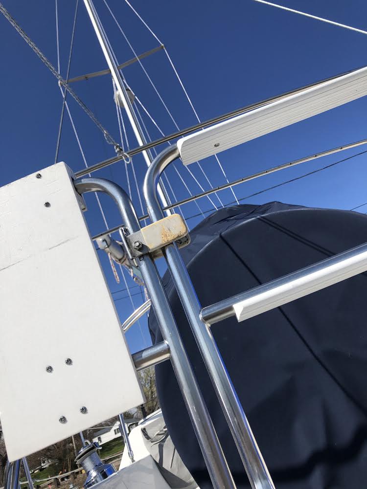

Anyone know where to get replacement transom gate latch covers? Mr. Sunshine has destroyed them...

Hi Peter,
Catalina Direct sells the entire fitting.  See:  Ladder LatchFor Swim Ladder (catalinadirect.com)

I'm going to try Plastisol dip.  I checked out a few you tubes and this looks pretty easy.   Just don’t use the gutter seal plastic stuff sold on tv....that apparently tends to drip easily.  Among the tips I saw:
- gently stir can, don’t shake as may incorporate bubbles
- wipe off the material being coated with alcohol to degrease followed by warming with heat gun
- slowly and steadily pull out the product being coated
- plastic coating can and item being coated probably best done in temperature 70-80 F
- stay tuned, I’ll do a follow up comment on completion.
A lot cheaper than buying new latches.

Dipping them in tool insulation works well.

I used the Plasti-Dip product and they still look great 3 years later

I found the best and cheapest solution  for my boat was to slide over a large size of black heat shrink tubing and shrink it on.
It has been in place for the last 7 years and looks great.

Another vote for white Plastidip. Lasts for years.
