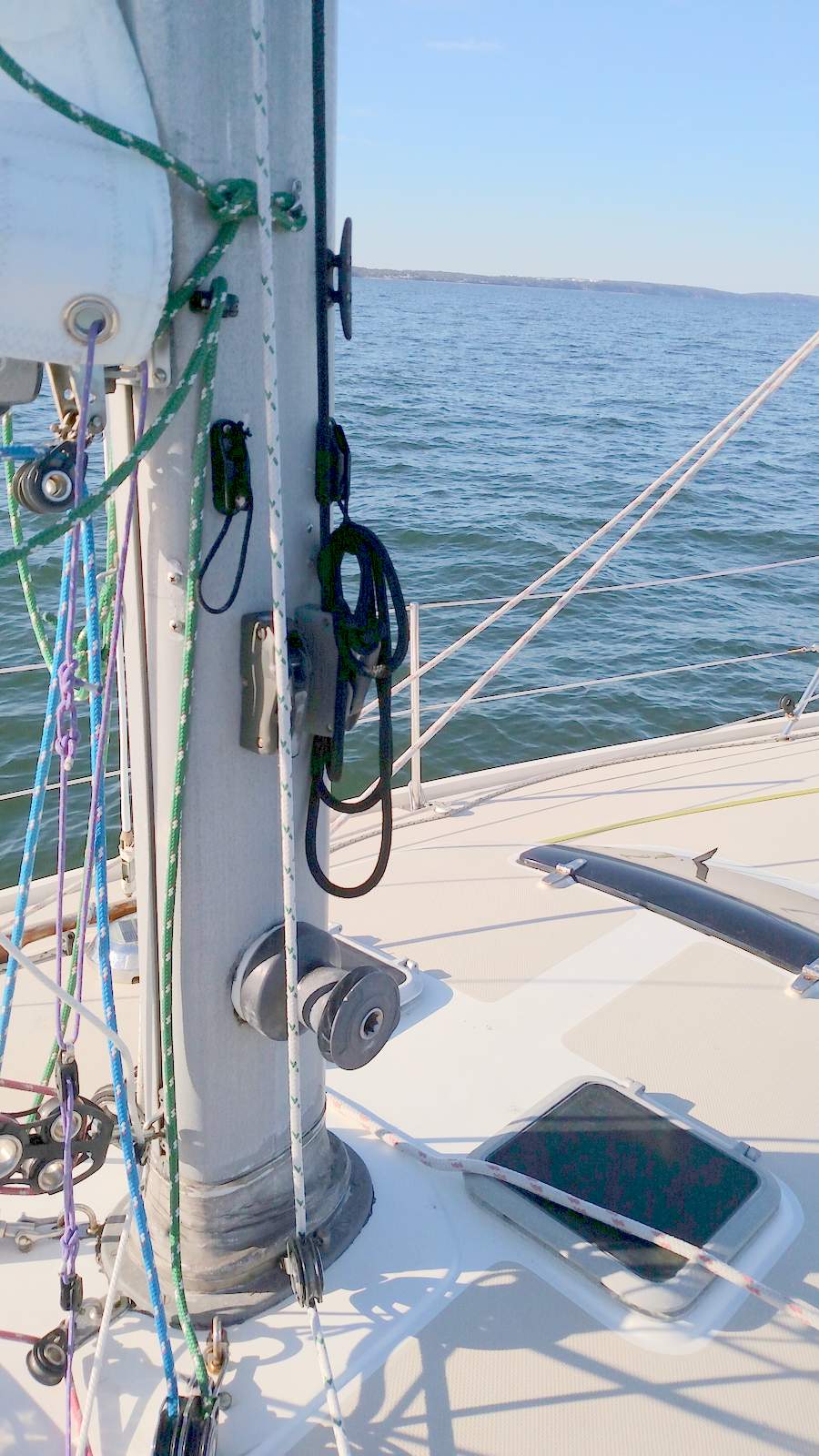

Personally, I prefer "jumping" the main halyard as it's faster and less work than raising from the cockpit through all those turning blocks.  When single-handing, however, you don't have the luxury of someone pulling in the slack from the cockpit and securing it with a clutch so you cannot just leave the mast.  When single-handing, I raise the main from the cockpit; it's not fun, but it works.
I saw an improvement on a neighbor's boat that I was thinking of adding to mine.  He added a vertical clutch to the side of his mast above where he grabs the halyard to hoist. He jumps the halyard as usual, and lets the line 'puddle' at the base of the mast.  He then goes to the cockpit and gathers that line in. Since clutches are one-way, he doesn't bother to release the top clutch.  In dropping, he opens the cockpit clutch, and can go to the mast to drop sail with the top clutch and gather it in.  He says he likes the system because of the ease in both directions and preferring to handle sail at the mast.  He does not use it in seas where the mast trip may be dangerous single-handed.  You can buy good quality replacement clutches used on eBay for about $50.

  When we first got our Mk1, like yours the only practical way to hoist the main was at the mast.  But we already had a rope clutch affixed to the mast, so we didn't have to bother with pulling all the slack into the cockpit (we just coiled it up at the mast).
  A few years back, I revamped the control line set-up so that -- among other things -- the mainsail could actually be raised from the cockpit (both because I prefer to be there during rough weather and to make single handing easier).   The key was reducing the friction on the main halyard, and to accomplish that I did several things, including replacing the sheaves in the line organizers with ball-bearing upgrades from Garhauer, and moving the line organizers further aft so that the turning angles were shallower.   Details and pictures / diagrams are on this post.
www.catalina36.org/comment/55992#comment-55992
   Although I still generally need to use the winch for the last couple of inches, it works sufficiently well, and no need for a second person "pulling at the mast to hoist it".   Cleaning and lubing the sail track and slides helps, too. (Someday I may add the Tides Track as well, but its well down the priority list)
    Alternatively, you could add a cleat and a rope clutch to the mast, so that you can raise the main by "jumping" the halyard, as others above suggested.  I added a rope clutch and clear for the spinnaker halyard (its fairly easy to drill and tap into the mast for the attachment screws, just use plenty of cutting oil, and make sure to use an anti-seize compound on the screws). See photos attached to comment #11 below

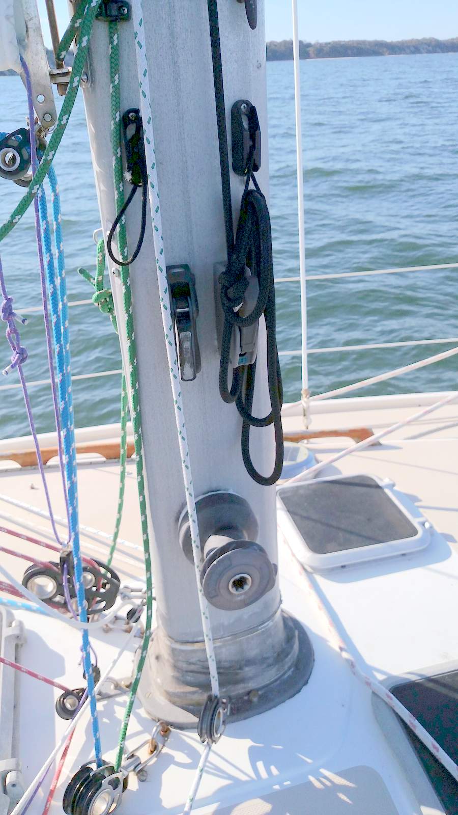

Ludo, I'm not convinced that Matthew's moving of merely the deck organizer further outboard is critical to improving the ease of raising the main.  What everyone with a Mk I is facing with this issue is not pitting or problems with anything inside the mast or non-ball bearing sheaves in the organizer, but rather with the fitting mounted in the side of the mast that the halyard emerges from (the technical name is escaping me).
When we're at the mast the halyard pulls freely because we're pulling it outwards from the mast.  When you try to raise from the cockpit the halyard gets pulled in quite tightly to the base of the mast where the swiveling blocks are, then across the deck to the organizer.  It is the friction (binding) against the bottom of the exit hole through the side of the mast that causes the problem.
I tested using a snatch block tied to the shroud to pull the halyard outwards, then back into the block at the mast base and it eliminated the problem. This is not a permanent solution, however, and the set up blocks access across the cabin top.  Installing an extension at the base of the mast collar block to lengthen it out would also do the trick, while somewhat blocking passage, however this would then chafe the halyard where it enters the deck organizer.
The problem could best be solved by removing the fitting in the mast and installing a new one with a sheave in it at the bottom (not sure I've ever seen one of these, but manufacturers might make one for  Hobie/dinghies).  I'll look at the problem again and search for a fitting online and at our local marine supplier and will report back if I have any success since even using a clutch at the mast (I installed a simple jam cleat which is dangerous as it often lets go) is problematic as very often the 'pooled' slack halyard at the mast base gets jammed when you return to the cockpit to pull it in, necessitating a return to the deck.

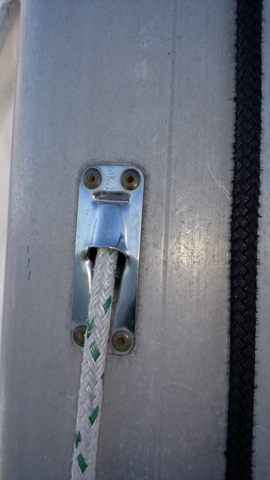

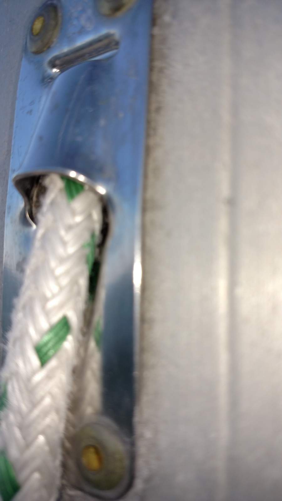

What everyone with a Mk I is facing with this issue is not pitting or problems with anything inside the mast or non-ball bearing sheaves in the organizer, but rather with the fitting mounted in the side of the mast that the halyard emerges from (the technical name is escaping me). [/quote]
I think its called a "mast exit plate".  I hadn't noticed friction there on ours (but I will certainly examine it, now that you point it out!). [/quote]
I checked the exit plates on our boat this weekend, no significant source of friction there (see attached photos).     But the masthead sheave remains no doubt the worst friction source for the mainsail halyard on our boat: indeed, last sail of the season yesterday, approaching the shipyard to be hauled out, and the halyard either jumped the sheave or the sheave was stuck, either way I had to yank the mainsail down.... Ahh, put it on the list for the spring....
