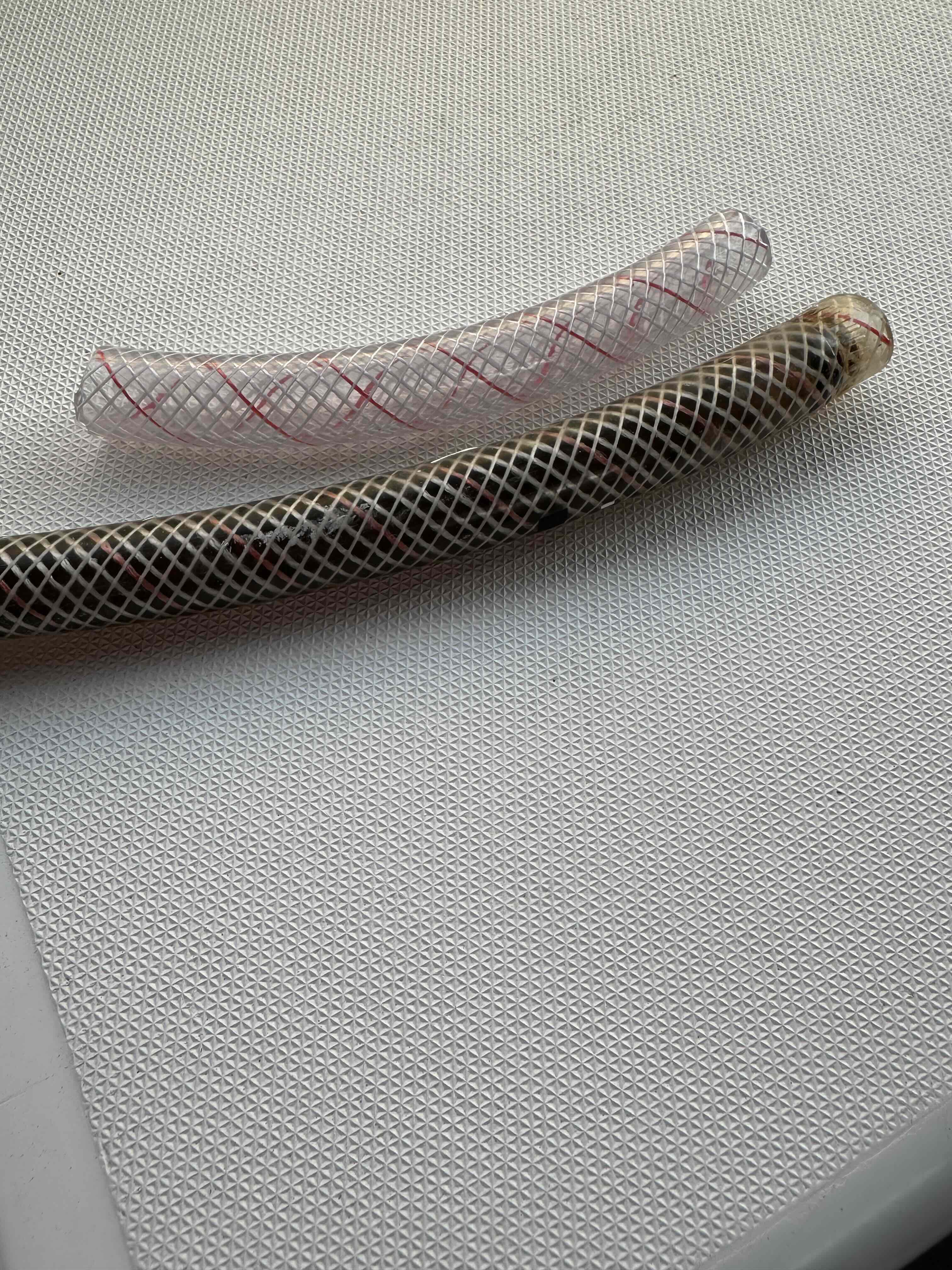

I don't have a clue what is causing your smell and neither does anyone else here. But I will share what I did to get rid of that rotten egg smell on my 2003 C36. I did purchased an anode to insert into the water tank. But I also purchased new water hose for the entire potable water system, I replaced my water hoses first and the rotten egg smell disappeared. So I didn't install the anode and the smell has not returned. Check the comparison of the two hose attached. My C36 is a 2003 model.
