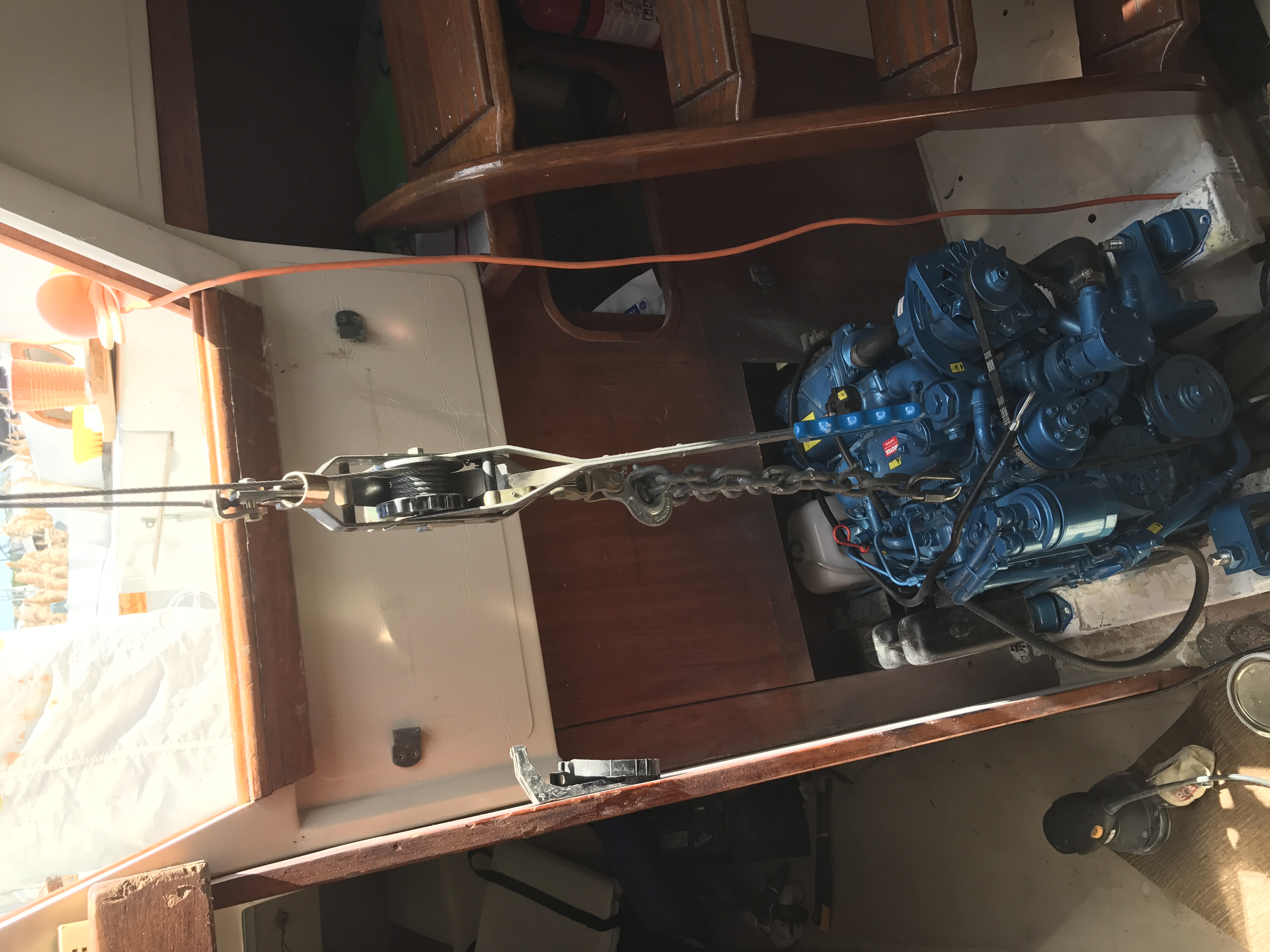

For those who considered repowering I repowered my catalina 36 with a Nani 3.3.   My second season with engine and very happy with this engine.   I had to modify the stringers slightly and cut about 2 inches off the shaft to allow engine to sit back a bit and upgrade exhaust to 2 inches.   The engine cover (steps) required no modification.

Hello Paul,
My 1984 C36 had a Universal Diesel 25 HP.    My new Nanni has a 30 HP at 3600 RPMs, the transmission is a twin disc 2.0 ratio.    I bought the engine directly from Nanni through a local rep so it was delivered to my house from France.  The engine sits a bit lowerso the only modification was to widen the stringer a bit and raise them 1.75 (ish) I used mahagony decking.   The housing that covers the engine (steps) required no modification that was the objective.  Then  I glassed the bed area.    So far I have only used my glow plug once in the two seasons running it.  The biggest obstacle was refitting my exchaust system but the silver lining was that I ended up with a nice space for 2 batteries where the old exhaust manifold lived.  If you are looking for a new engine and want to avoid any modifications consider the beta, I believe they have a direct fit that will exploit your old exhaust manifold.   Unfortunately I do not have pictures on my new phone but will be back at the boat next week and will take a few.    The boat is in Marion Ma.
