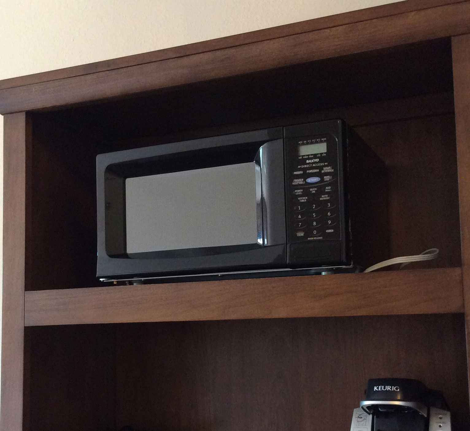

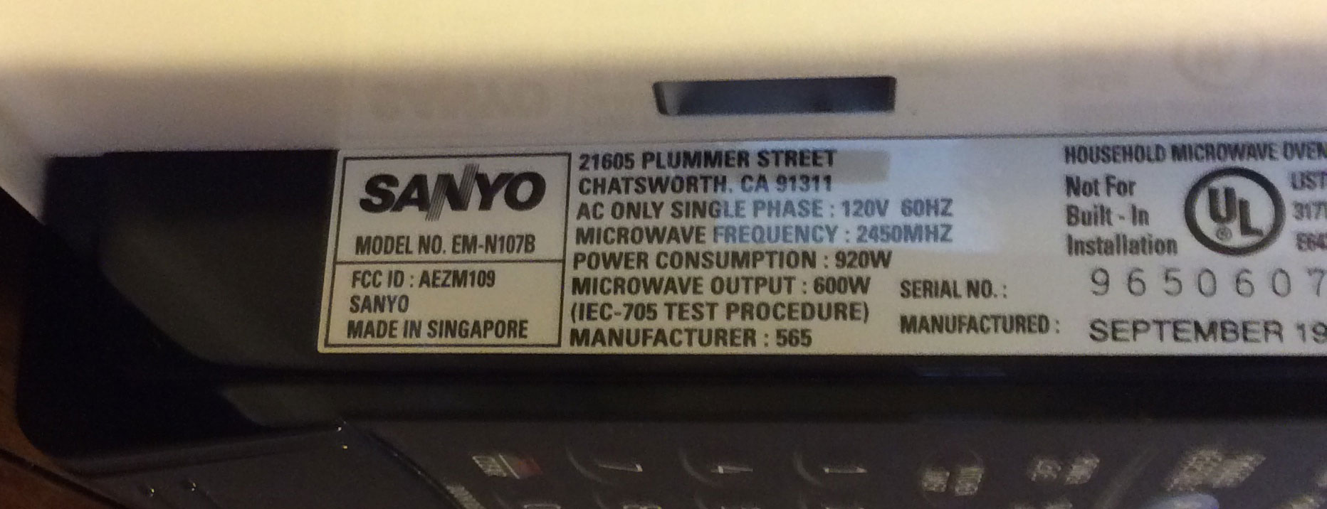

Fellow C36 owners I have great news!!!  I had to be in Horseheads NY to visit a client today. Got in late last night and this morning while getting dressed I noticed the microwave.  Wow! It looked small. Kind of the same as in my Catalina 36MKII......  Why I'll be darned....it is!!!  Woo Hoo!!! It's a Sanyo Model No. EM-N107B.Date of Manufacture: September 1999. Check it out!
I explained to the hotel manager and that I wanted, no, I needed to take that microwave with me for my boat. Guess what. She said OK! My cost? $75, the price she spends for new ones at Lowes. I mentioned there are many other boat owners like me that have been searching for this microwave. She says she would be happy to accommodate any others who might want to purchase these as long as there units to sell. This is not a small place so now is the time for all who need this microwave to act! Probably will cost just north of $100/ unit because she would be shipping and handling, but so what! Her motivation is to put new units in the hotel. I have to say it looks brand new! See attached photos.
Not sure if our posting rules allow me to publish her name and contact info so for now if you want her name and contact info please email me at kevin.silver@verizon.net.

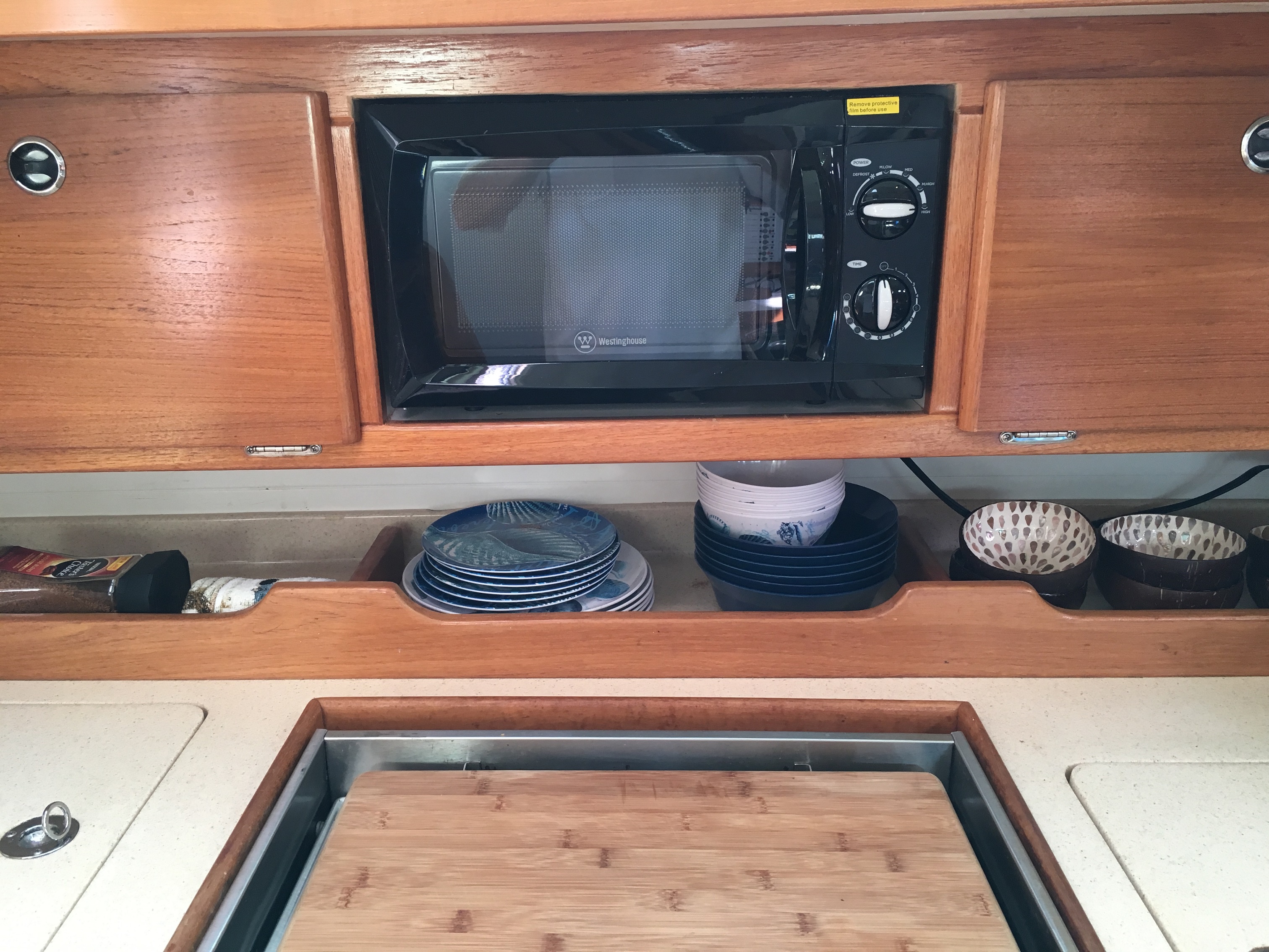

My original microwave didn't crap out but it became too ugly to look at, and an attempt to make it pretty proved more labor intensive than I was willing to do.  After a long and rather intensive search, I was unable to find a replacement that would fit in the existing shelf.  I settled on a Westinghouse 600 watt MODEL WCMB/W.  It is black and has no clock.  That way it isn't using juice when not being used, and there is no need to constantly reset that pesky clock. It uses a simple twist timer.  The down side of the whole issue is that it doesn't fit in the existing shelf.  However, removing a small  amount of the overhead wooden enclosure is all that is needed to fit this rascal in. I was able to pull this off by carefully clamping a straight board under the overhead enclosed as a guide and straight edge for the small cordless electric circular saw that I use to make that critical cut.  That worked well.   There is the rub.  A small screw-up will leave a noticeable blemish.  If you are brave enough to try this, you need to know that there some through bolts and nuts hidden in the overhead board.  Remove the teak plugs and check the depth of the bolt before making your cut line.  Again, no big deal.  After making this very critical cut you will have to finish the cut to both ends with a small hand saw.  A hacksaw blade will work just fine.  A bit of sanding to round the edges is all that is needed to finish.  I am quite happy with this little microwave and the installation.  I use the microwave regularly.
Captain Moon

The full model number didn't make into the above text.  It is a Westinghouse model WCM660B/W.
Captain Moon
