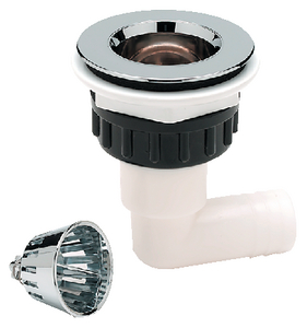

Richard, I recently found my sink drain leaking due to broken plastic nut. You can get the original part for about $25.00. It is manufactured by Forespar Marelon. I will place more info with photo by Monday. There is hope.
Stay tuned
Haro.
More info added:
They are Forespar Marelon Forespar 907017 90° 1"I.D. Sink Waste Drain,
Forespar 907017 1 Id Sink Waste 90 Deg Sw-4
Features: 90° configuration 1" I.D. tubing 2-7/8" flange 2" cut-out
Forespar SW-4 Sink Waste / Drain
Available from
   https://www.boatersland.com   866-828-1033    $ 24.99 + Freight
   https://boatplicity.com              888-854-6152     $ 23.86
   https://www.defender.com       800-628-8225   Item # : 501267    800-628-8225     $ 28.99 + Freight
Posts: 742
The drain has an "X" molded into it. Insert needle nose pliers with jaws bridging the X to stop the drain from spinning as you the turn the plastic nut on the underneath side. The drain is made from chrome plated plastic and will not bond itself to the stainless steel sink through corrosion. There is a sandwiched rubber gasket that creates a lot of friction and makes the nut difficult to turn.

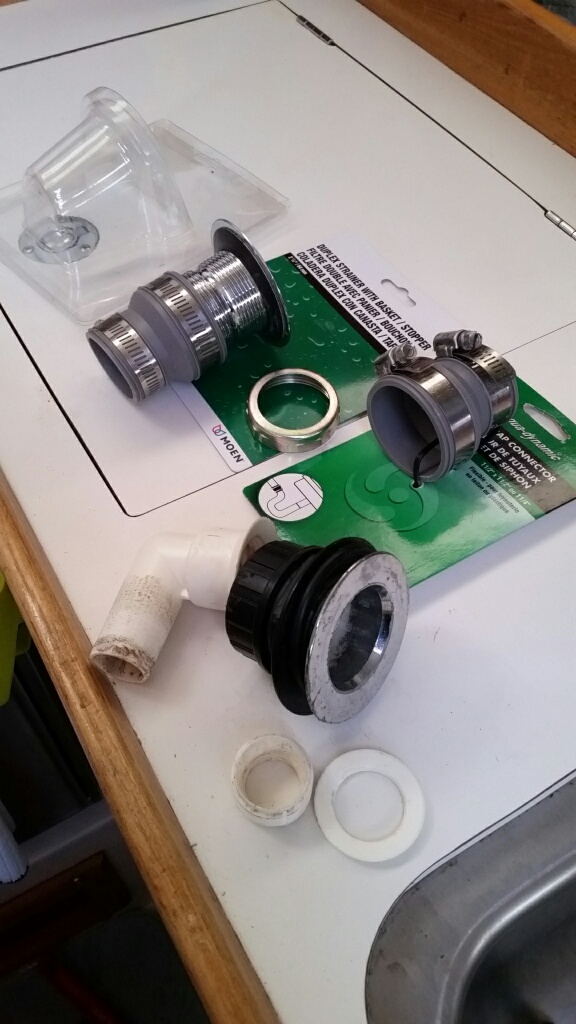

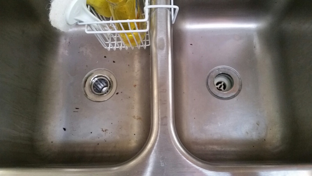

We had a similar problem 4 years ago when the boat was new to us.  The original chrome plating on the plastic drain fittings had corroded through and was causing a leak. (See port side drain in attached photo.)
Everything came away fine from the stainless steel sink cleanly, but as I was in a hurry instead of ordering the proper marine fittlings online, I just wen to Lowe's/Home Depot and bought the fittings you'll see in the photos in the link below.  Cheap, easy and works well.  As these are drains there is no issue with pressure in the lines.  An anti-siphon might be a good idea, but none was originally installed and I believe this was the reason for the original very deep sinks?  Extreme heel to port might bring some water into the port side sink, but the sinks are fairly close to the centerline of the vessel.
I did remove the screw bungs and took out the drawer assembly.  To ensure a seal without the proper sized washers I used Auto Goop around the sink on top, stick-to-itself plumber's tape on the threaded shaft of the new sink fitting and cut off the plastic disk to make a collar that would press up against the underside of the sink, then reused the plastic elbows and reassembled.  Remember that the down-pipe below is below the waterlilne!
Link to pics:  https://www.flickr.com/gp/47932873@N00/06u5z9
I did look into getting a new single shallow sink, but the only version I could find online (see old thread re: "new galley sink" in the forums) was too expensive at $350 or something like that.  The job looked a bit daunting to effect the swap and the Admiral said she was fine with the original twin bucket sinks.  I would likel to eventually change out the faucet for a one-handed version.
