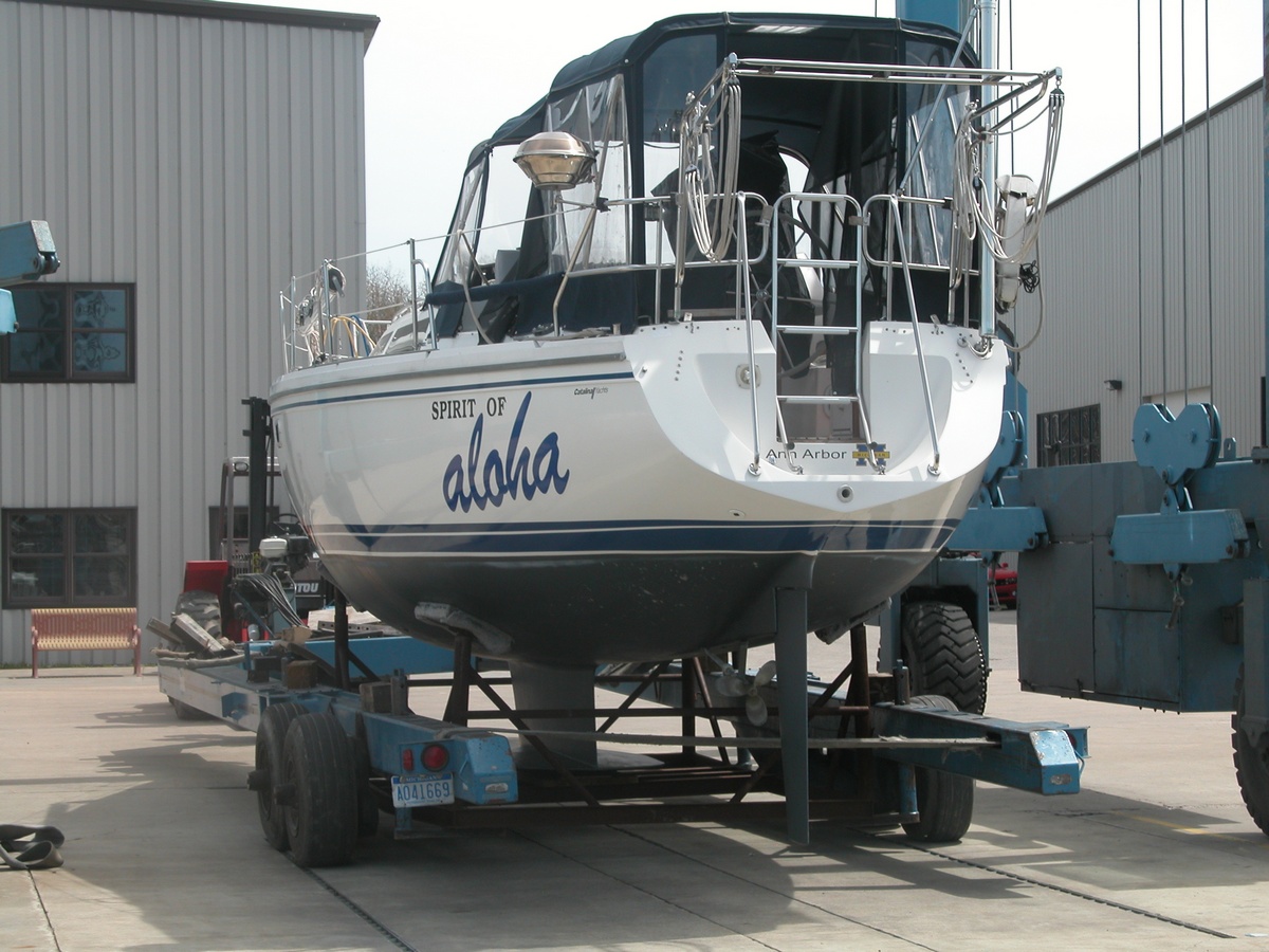

I have "Kato" davits on my boat.
I have never regretted my decision and I would do it again.
I do have stabilizer bars on my davits to take the load off my railing. IMHO that is essential for a solid support system.
Bill Matley
Cheboygan, Michigan
Lakes Huron, Michigan,
Canadian North Channel
"Spirit of Aloha" Hull #1252
