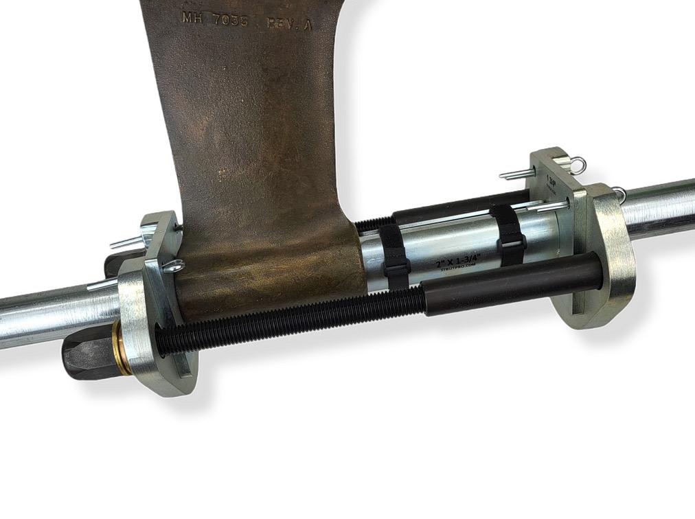

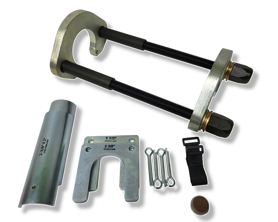

I've removed cutlass bearings the old fashioned way - shaft out cut carefully from inside the strut and destroy the old cutlass bearing to get it out. Last time I used a borrowed Strut Pro tool and the job was actual easy and quick. The tools's hardened shims are about the same size as the cutlass bearing. Once set up as you turn the screws the shims push the old bearing out along the shaft (push toward the propeller end). Slip the new bearing over the propeller shaft and reverse the process to install.
