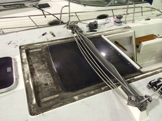

During the summer my boat showed signs of moisture in the forward corners of the companionway hatch hood. I removed it last weekend to determine if the issue was serious. I am assuming that the PO had never removed the hood and the adhesive/sealant was from the factory. It was a pain to cut away and consumed about 3 hours of my morning.

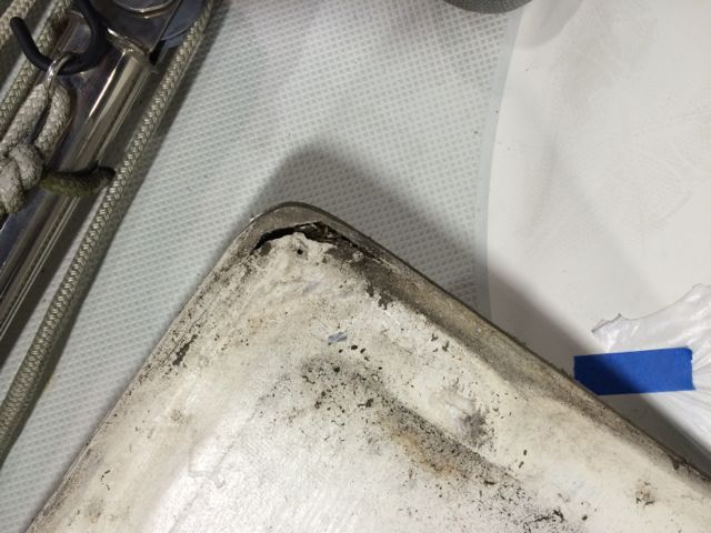

I attached a few pictures showing the dirt/kludge that collected and also that I had fiberglass damage on both forward corners of the hood. As you can see this damaged a bit of the core. I was going to try and attempt the repair to the hood myself, but I have quite a few other items to finish up on the boat before the spring launch so I am having a local glass repair guy take of it.
I am assuming that water was getting through the sealant at the covers or somewhere and cause the fiberglass core issues.

The last picture is after my initial cleanup of the area under the hood.

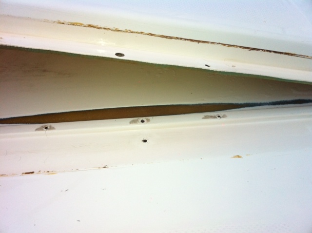

The first pic shows about an inch or so of grey dirt that had accumulated beneath the fixed sliding hatch cover (the hood is it called?). Since neither I nor the PO could get in there to flush it out, it had been accumulating for several years.

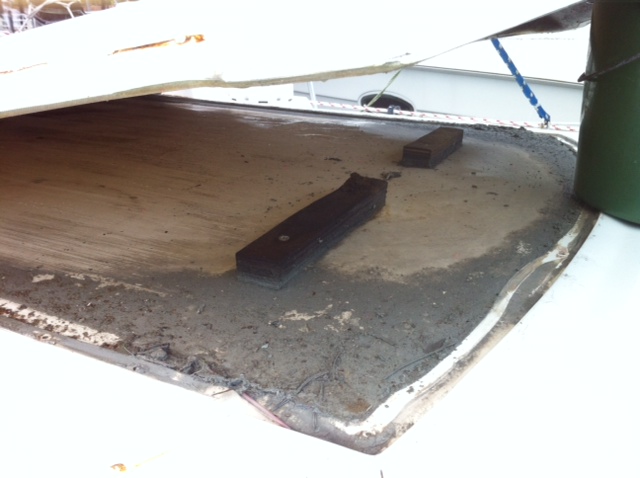

As shown in the second pic, when I unscrewed the fixed hood to open it up (PITA since the traveler won't let you remove it all the way...unless you remove the traveler - an even bigger PITA) I discovered that the dirt had been grinding away the fiberglass on the sliding hatch cover, like sandpaper. Yikes! Good thing I caught it before it could grind it down to structural unsoundness. Otherwise I'd be having to rebuild the sliding hatch cover too.
