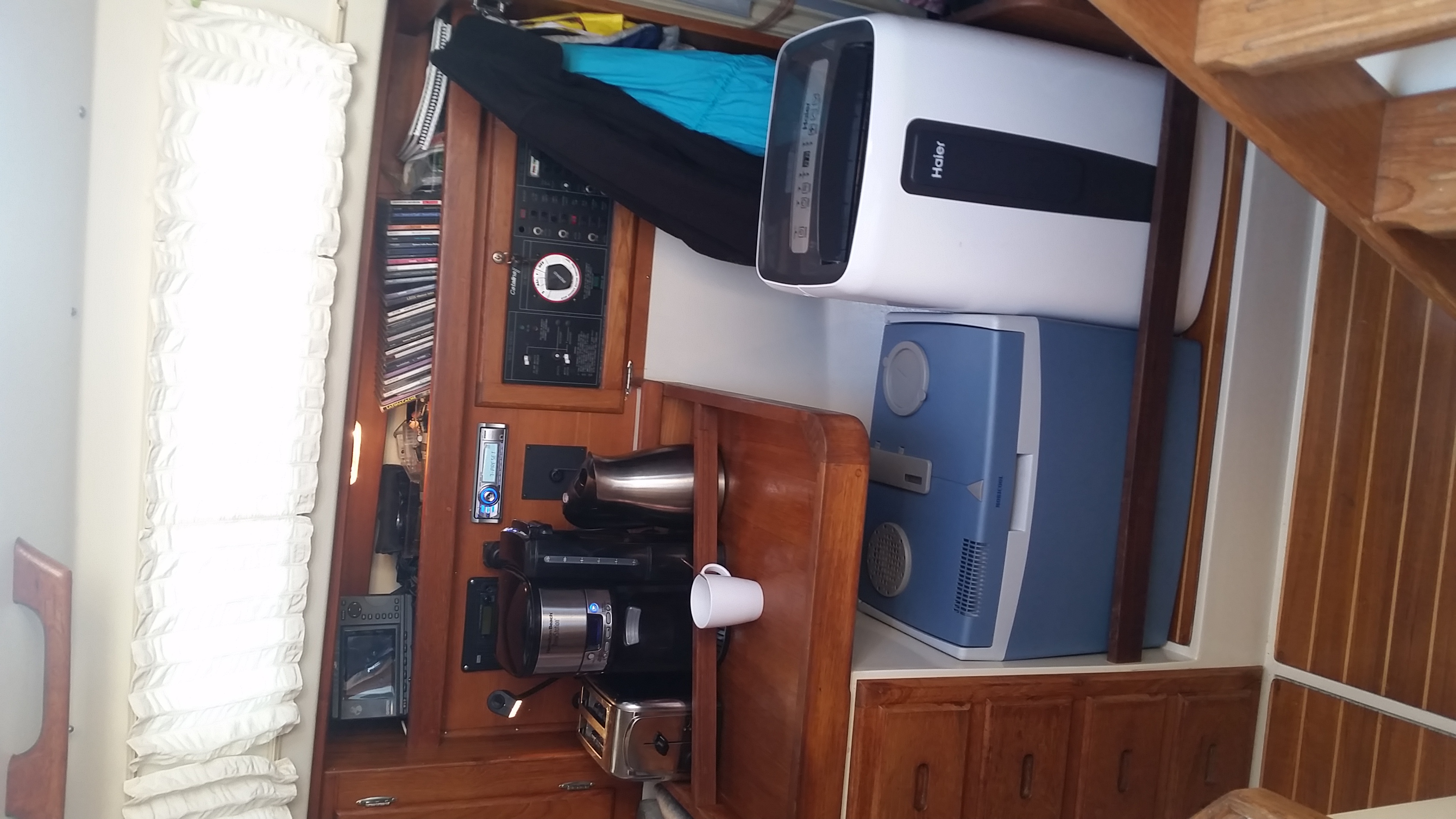

I was going to install a propane/110v/12v fRidge from an RV bit that deal fell through (would have fit the tight bottom space ideally), but ended up with the correct sized cooler (I pump out the ice melt water with a vacuum extractor every morning) and an A/C/heater/dehumidifier that I vented through and out the rear cabin. See photo.

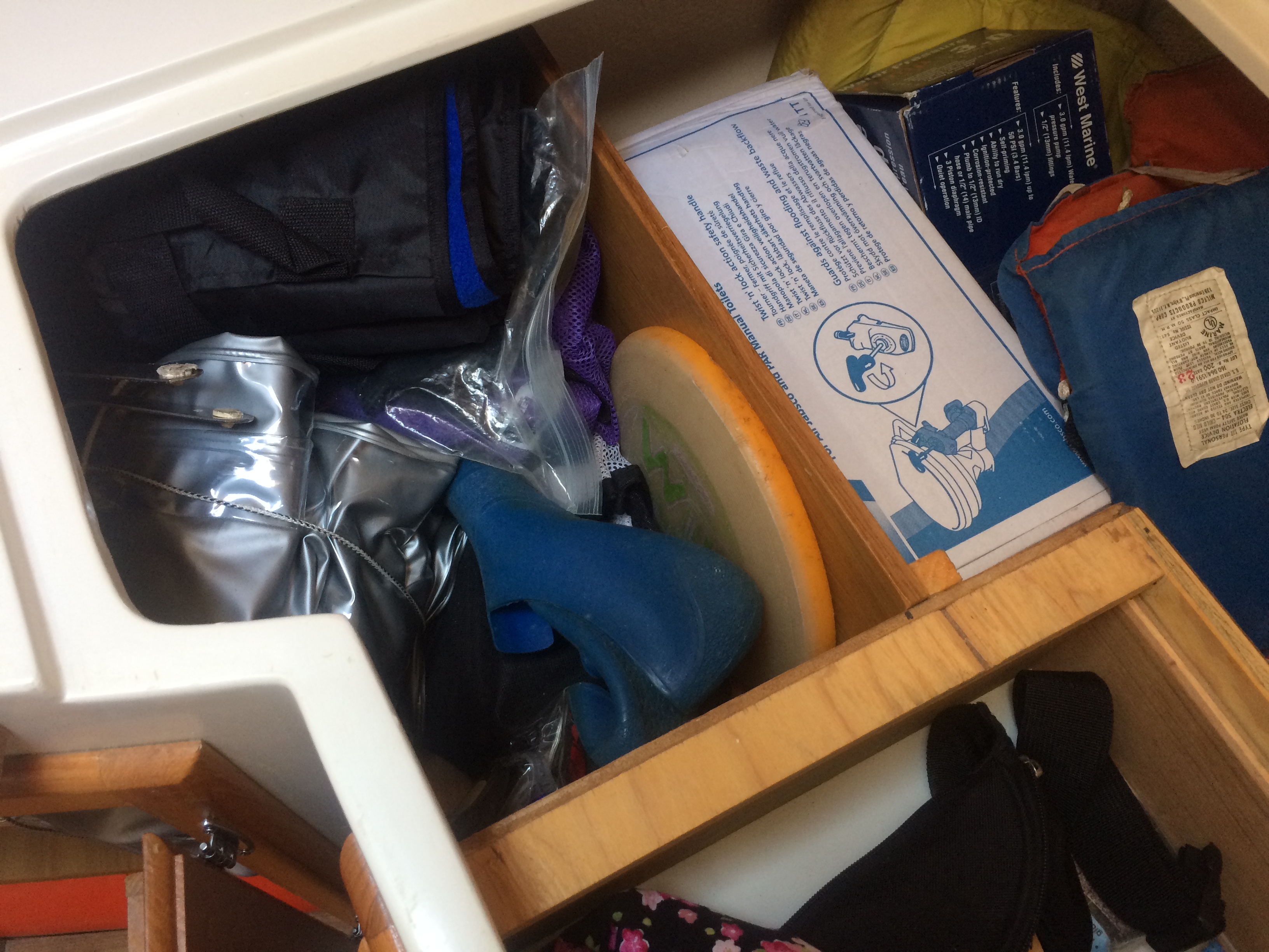

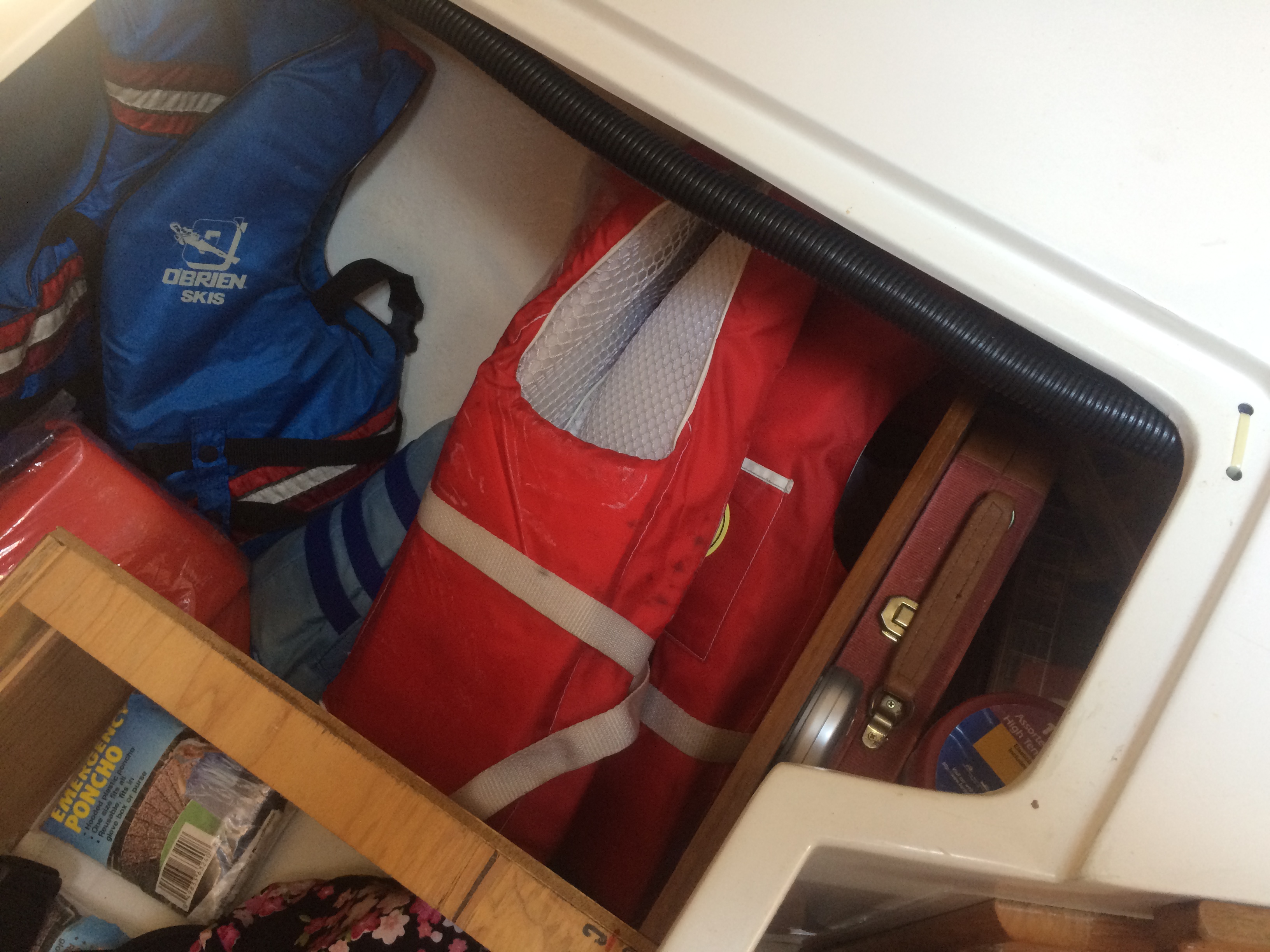

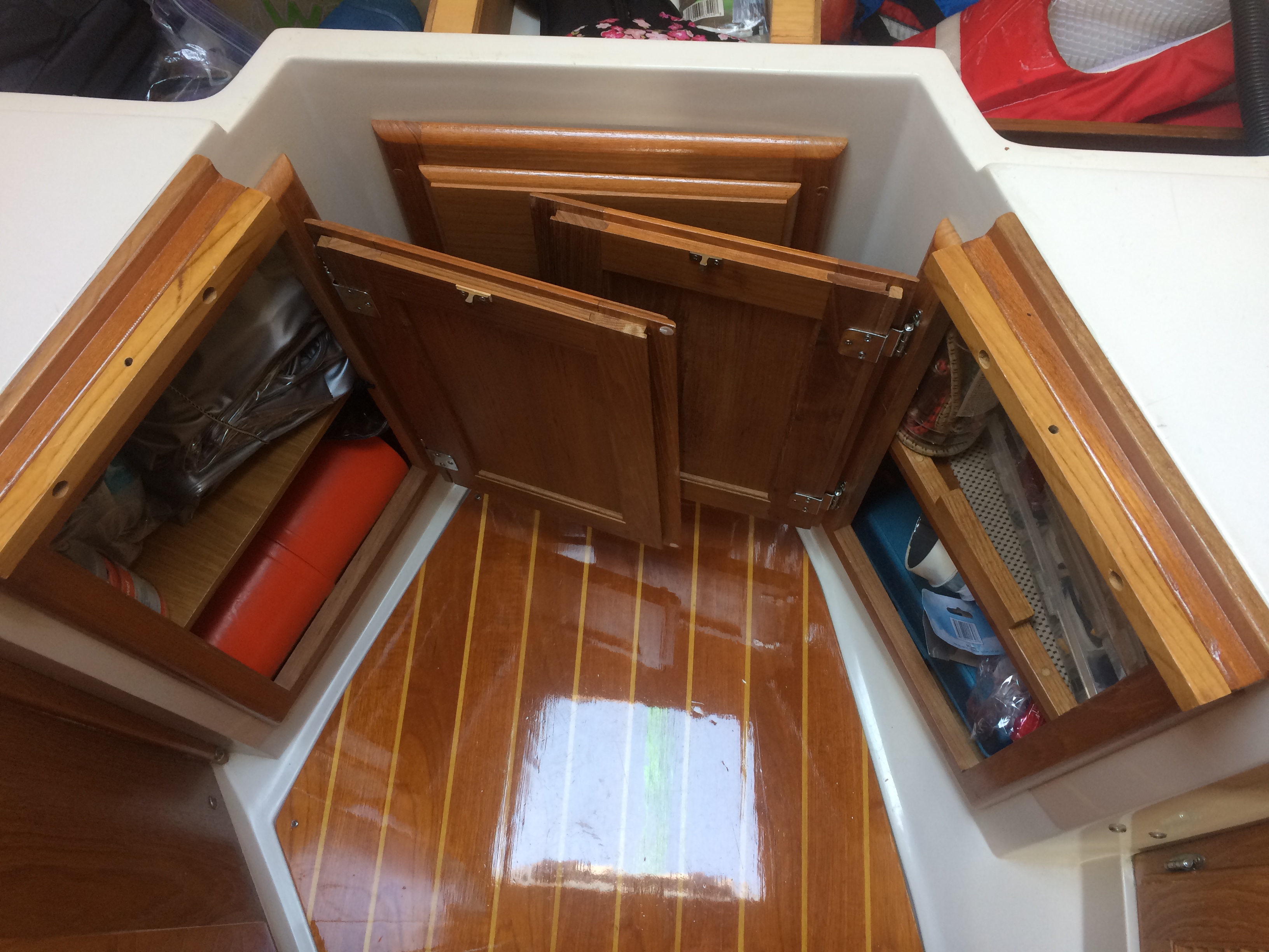

Years ago I modified those pull outs into cabinets. I built bulk heads forward and put shelfs in and used the pull out face as a new door. Much more usable space. Not sure if I did a write up on this mod but maybe something to do down the road.  If interested and have questions email me off line and maybe I can help.

Here are some pictures of my modification. You will notice I made cabinets different sizes and doors swing in.

That really reclaims some space.
The floor, so shiney, so beautiful, so inspiring.

​Looks good, what stain did you use to finish off the doors?
chic
Joined: 2/13/08
Posts: 88
Polyurethane satin finish from Home Depot.

I took the wedge shaped bits of the doors anc mounted the doof hinges on the door side. Left the space for bulkier item storage. Much better than those stupid wedge shaped containers.
