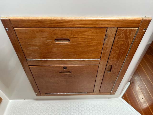

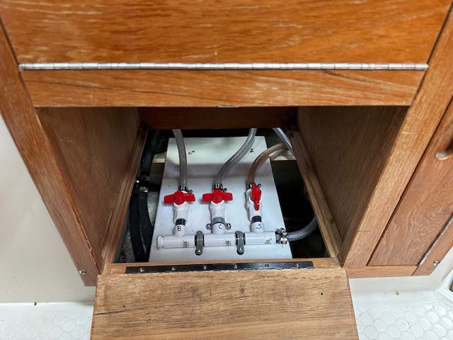

After the water valves started to be tough to turn on & off, and not easily accessible under the main salon settee and beneath the AC venting, I mounted new valves in a little used galley drawer.I put in a new sub floor, and used the old drawer front panel, then added a piano hinge and magnetic closure. Now when doing dishes and the water runs out, the valves are easy to reach.
