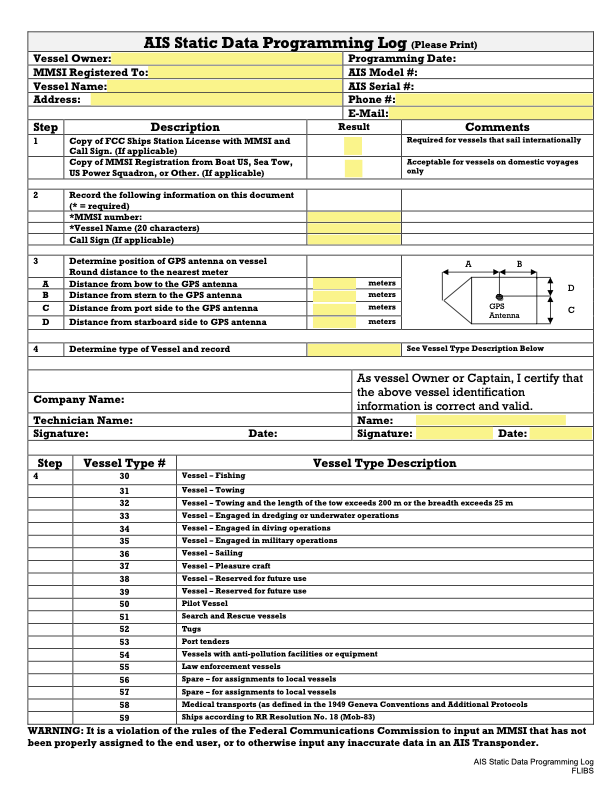

Attached is the form I used, it asks for the relative location of the GPS antenna attached to the transponder, not the VHF antenna.

Right- exactly.   The transponder I’m getting uses the same common antenna as the VHF.   So that’s why I’m just using distances to mast.
