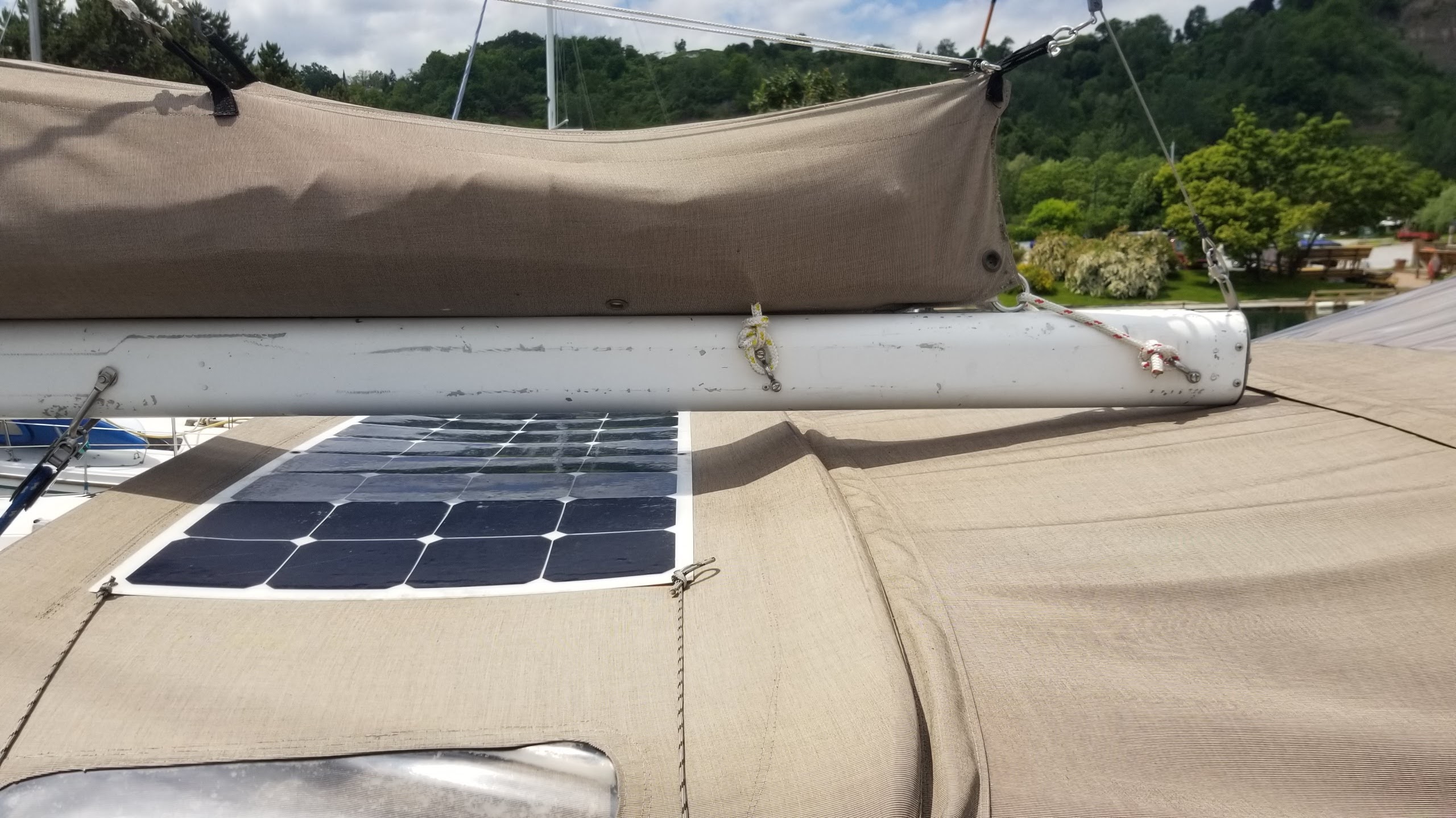

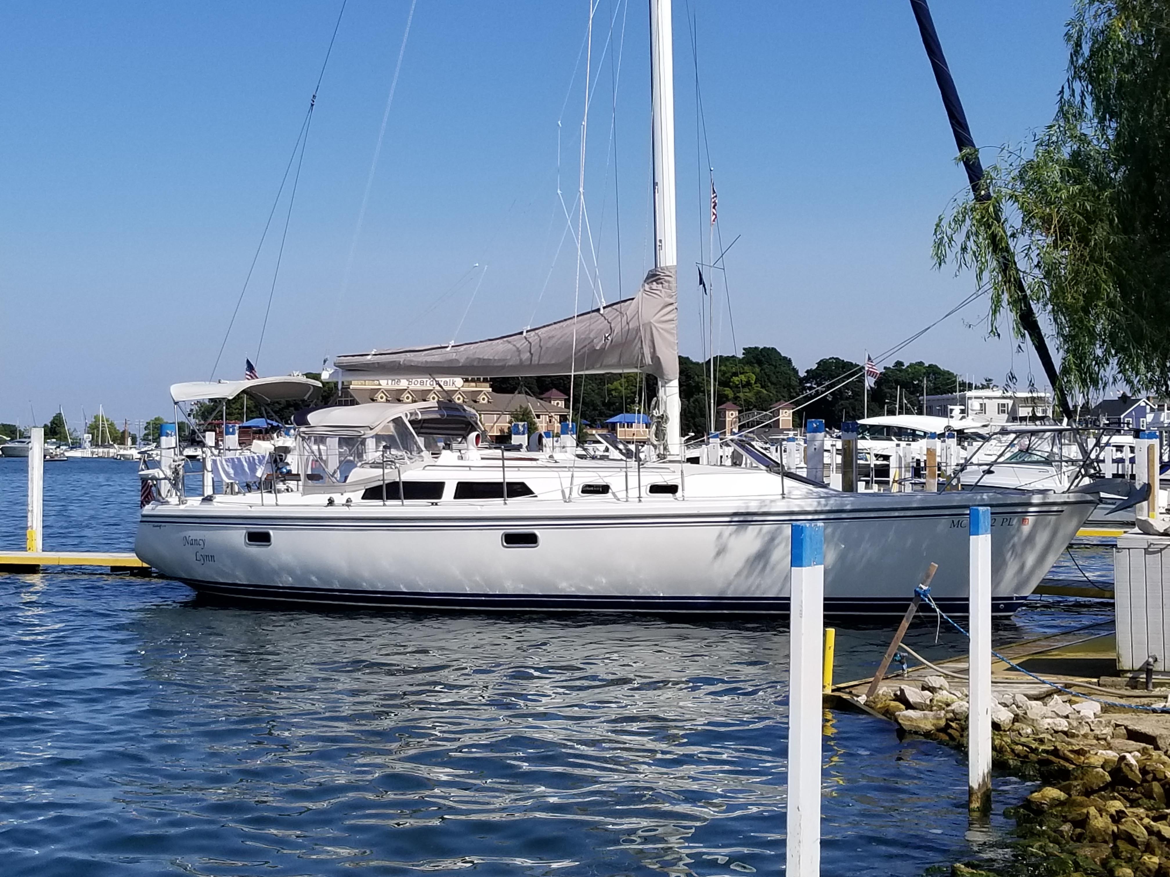

I don't understand how a dodger could be arranged so that you have standing headroom under it.  Do you have to raise the boom height and recut the main shorter?  I have a "regular" dodger that I routinely whack my head on, but the clearance between the boom and the dodger is only a few inches.  In this photo, you can see that my bimini (with standing headroom) is the same height as the boom.  There is no way I could have a dodger any higher than what it currently is.

My apologies, Don Lincoln, allow me to revise my claim (as I have never actually measured the height of the aftmost dodger support arch) from 'full standing headroom' to 'sufficient clearance that a 6 foot tall person never consciously thinks about ducking when moving in and out from helm to companionway'.  We have a tall rig, but looking at your photo I believe you have the same boom height, our difference being that the dodger is just an inch or two lower than the bimini with about that much clearance between the bottom of the boom and the top of the dodger.  See photo for reference.  K.

Got it!  It looks like chafing hasn't been a problem either.  Interesting!
