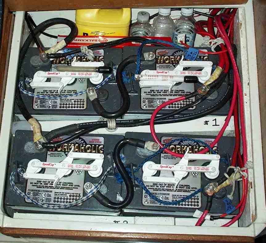

I added four 6 Volt Golf Cart batteries to Gone with the Wind nearly 5 years ago. They received high recomendations because they can be discharged rather severly and recharged. They did cost a bit more but I am totally satisfied with their performance. I did several other things at the same time ie. add a Link battery monitor and change all the wiring plus a new alternator and regulator. Someday I will put together the story. There are several others in the old forum. One of the other reasons I used the golf cart battieries was by using four in series/parallel I could disasemble the bank in the winter and carry them off the boat and maintain at home. They do weigh about 60#s but lighter than the larger battieries. :) This also helped me with the listing problem that the MK1 has to starboard. I put all four battieries in the aft port setee. I have a backup 12V in the forward setee.

Yes you are going to have to pull the tray that exists and fabricate a new one. In my early reading I came across a suggestion that you make a model of your battery out of carboard. Make it an actual size. I made four as I knew that was what I was going to use. Immediately it showed that with the existing pan it would not work. I too wondered how hard it would be to remove the pan. I grabed the outboard edge and noticed it moved. Still not sure what would have to be done I anticipated that I would need to use a saws all and perhaps chisel some of the tray away. I made a decision to tug on the tray one time to see if it would come lose. I did, it did, and I ended up on the floor and scraped my hand as I exited the cavity. Inside after you pull it you will find that Catalina used a scrap block of teak and some goop to hold it all together. My boat hull # 1056 was manufactured in 1990. I'm not sure what they may of used at that time. Perhaps 5200 just not sure. Anyway I might suggest that you apply a heat lamop to the area and perhaps it will make the tug a little bit less.
Having said that then I designed my platform and figured out how I would secure it.
Another thing you are going to have to do is cut away a portion of the seat. You can get 3 batteries in the cavity but the fourth becomes impossible without altering the seat top some. Do not worry as it will not show.
I'm planning to write my installation up in 3 or 4 segments for the web page or newsletter. I will try to do this soon. I have some pictures and just need to sort them and write something up.

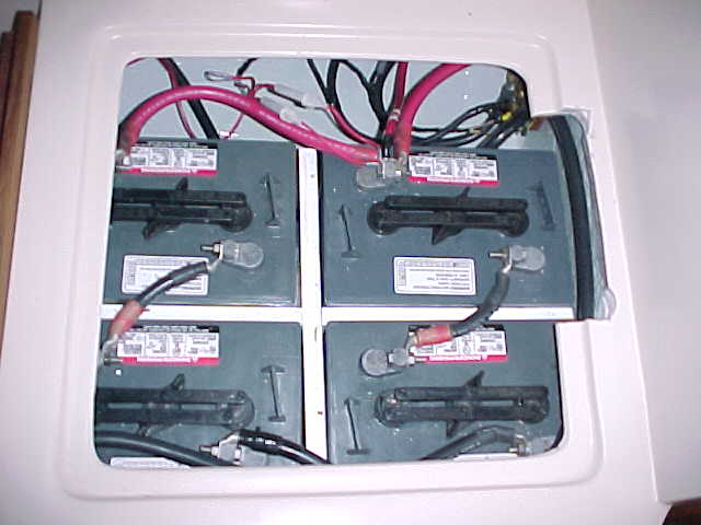

In my case when I added golf cart batteries in 2004 I did not remove the original battery boxes. First see how much room you have at each end of the boxes and determine if one end can be enlarged. In my case I had 5/8" space available at the aft end of the boxes.The batteries I chose were US Battery US2200, same battery as Interstate U2200. These batteries measure 10 1/4" X 7 1/8" x 11 1/4h. When placing two of these batteries end to end, they measured 20 5/16" at the base. I had enough room to extend my boxes about 7/8". My old box measured 19 3/4" at the base.
I took my Dremel tool and a cutting disk and made a cut 2" from each end. My boxes were attached to a plywood platform with 3M5200, so I heated the ends and then pryed each end off with assorted prying tools. The ends were re-attached with 5200 on their plywood base and placing the new batteries in the enlarged box while the 5200 dried.After drying I removed the batteries and used glass- thickened polyester resin from an auto supply store to fill in the gap. Thickened epoxy would have been better. I then applied glass cloth and epoxy over the joint for strength. No problems after 5 seasons and a lot easier than trying to remove the entire box and building a new one.
My batteries cost $53.95 in 2004 and now cost $95 each. They were $150 just a few months back, but are coming down in price as lead continues to drop back to $.45/lb compared to its high in 2008 of $1.76. Wait till the last minute to buy your batteries because each shipment your dealer gets will be lower in price.
Attached is my completed battery compartment.
