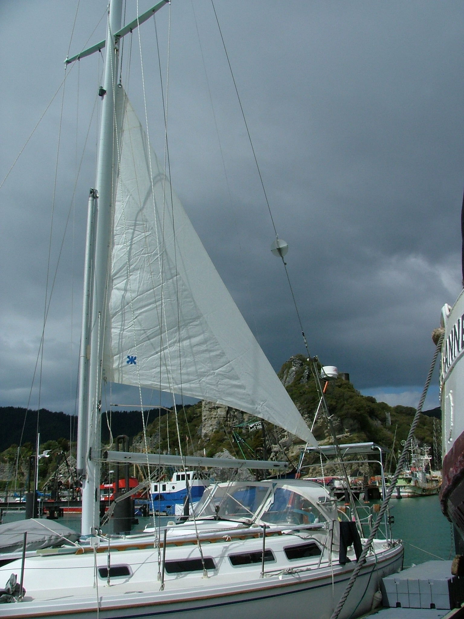

We installed a separate track on the mast and halyard for our trysail for our trips from New Zealand to the South Pacific Islands.   We have never required this, and hope we never do :-)   It's a bit of a pain to set up.   We did fly it once in 15 knots, and there's not enough cloth for it to move us at that wind speed.

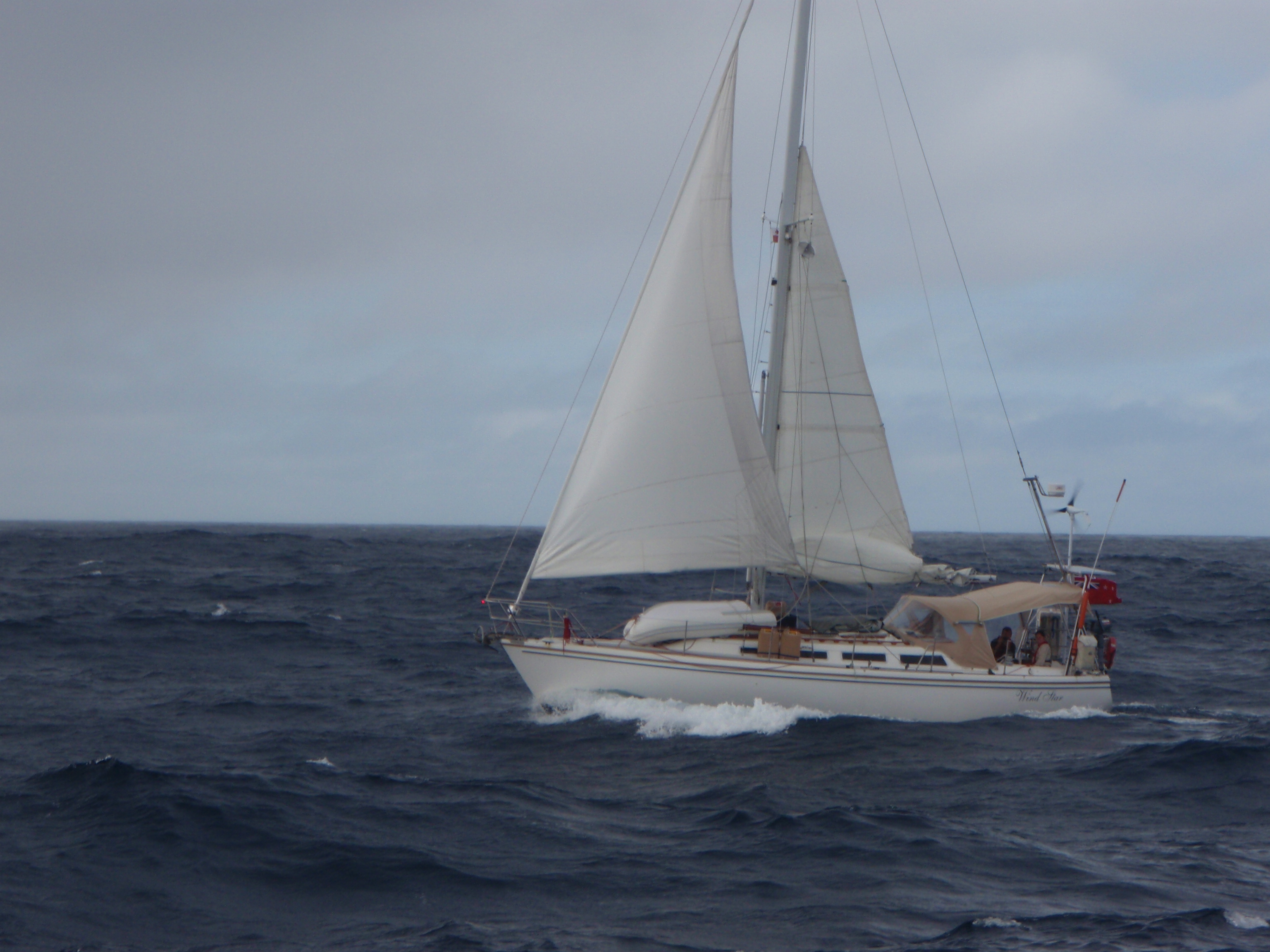

Generally we use the third reef, and I will recommend this to anyone sailing in gales.   It's much easier setting the third reef than hoisting the Trysail, and the main is not a huge amount larger than the trysail anyway.
Photo attached before the separate track was fitted.
Other photo shows the third reef.   Please excuse the lazy billowing bunt!
