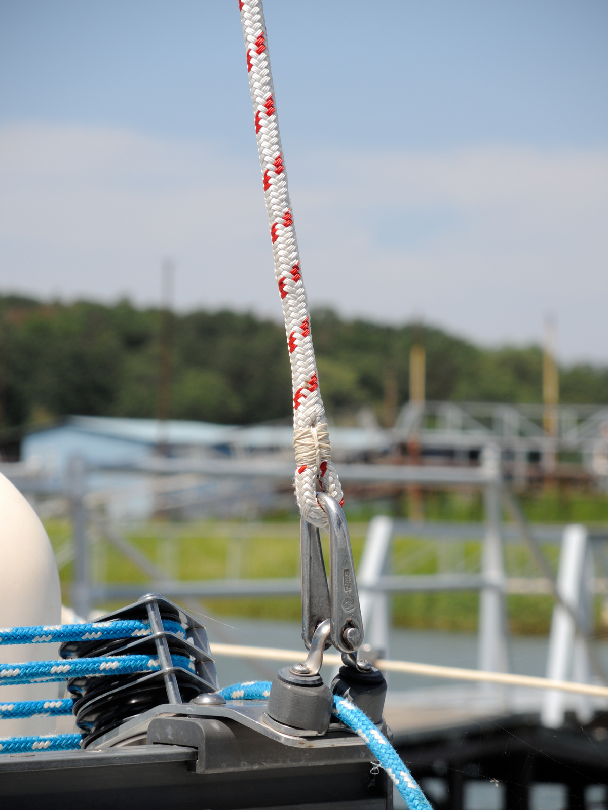

I has hesitant to splice double braid but I watched videos and decided to give it a try.  I used this video to help me through the process: https://www.youtube.com/watch?v=UghIS9xdiDw . I like 'talkies' :-) My approach was find a  video that you understand and give it a try.
Here's a picture of my halyard and shackle splice:
Ralph
Still a Thrill # 765
WK, STD Rig
Lake Texoma, TX
Hey Ralph - looks great; and you now have a skill that you will be able to use in countless ways around the boat!
