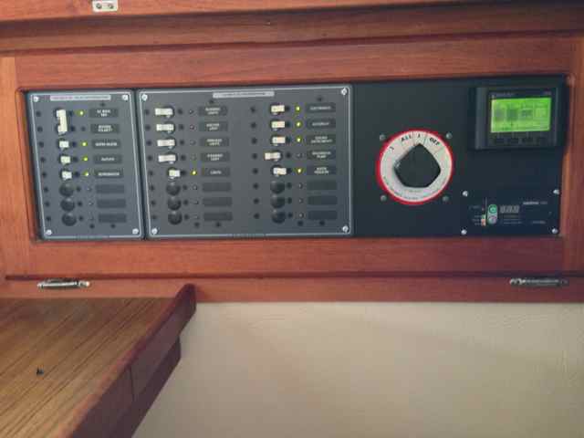

Thanks for the suggestion Ben, I'll check around for parasitic AC leaks. I have installed a brand new set of electrical panels with an LED based reverse polarity indicator which I would expect to be high impedance. It's possible that the old dorm fridge or the microwave could be leaking/bonding neutral to ground, but again, the shore power ground is going through a brand new isolator. I suppose if there's enough AC leakage on the neutral it could push the isolator diodes into conduction and render it ineffective. I'll let you guys know what I find if I make it down to the boat this weekend.
Thanks! Ellsworth

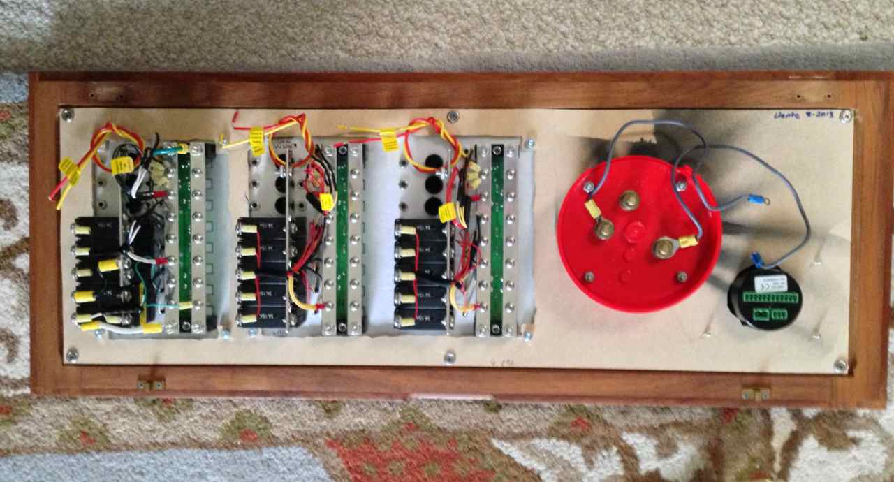

attaching a pic of my new panel:
Ellsworth Wente
S/V Wind Dancer, C-36MkI hull #256
BTW - if any of you decide to do a panel upgrade, black chalk board from home depot for ~$5 makes a great replacement for the old fiberglass. You can cut out the holes in it, and mount all your new goodies and have plenty left over!
