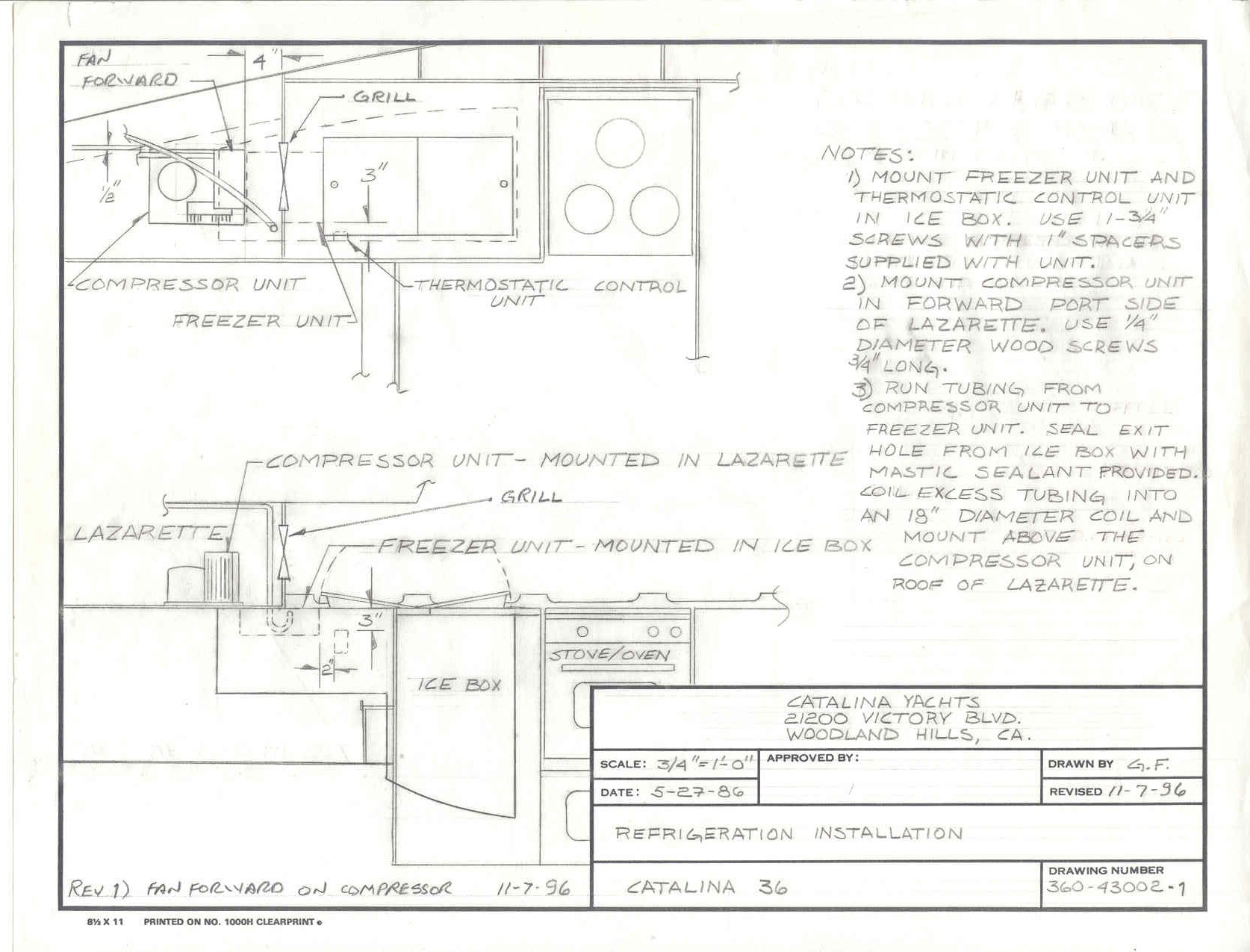

Sam,
The unit was installed by the P O against the forward outboard wall. If I were to do it, I would cut a slot in upper aft wall of the box and build a small enclosure on the back of the box to house the aft few inches of the cold plate, and mounting the cold plate to the top of the box just aft of the end of the rear of the lid. I would leave a couple inches between the top of the cold plate for air flow. A small fan would enhance circulation. The thought being the shelf just bellow the cold plate in the aft section would be the freezer section and the deeper forward section would hold more beer. I need to turn mine off after about four hours now if I put the beer in the forward section next to the cold plate to keep from making beercicles.

Capt. Sam's picture
Capt. Sam
Joined: 2/22/10
Posts: 322
Thanks for the link Jack. I read it and Man! what a project. I'm afraid I would rather be sailing than taking that on. I'm just trying to get things back to where they were. Has anyone got a SeaFrost BD aircooled system?
Its much like the Adler Barbour but supposedly more efficient. Cost about a hundred more. Would appreciate any comments from someone with experience with this unit.

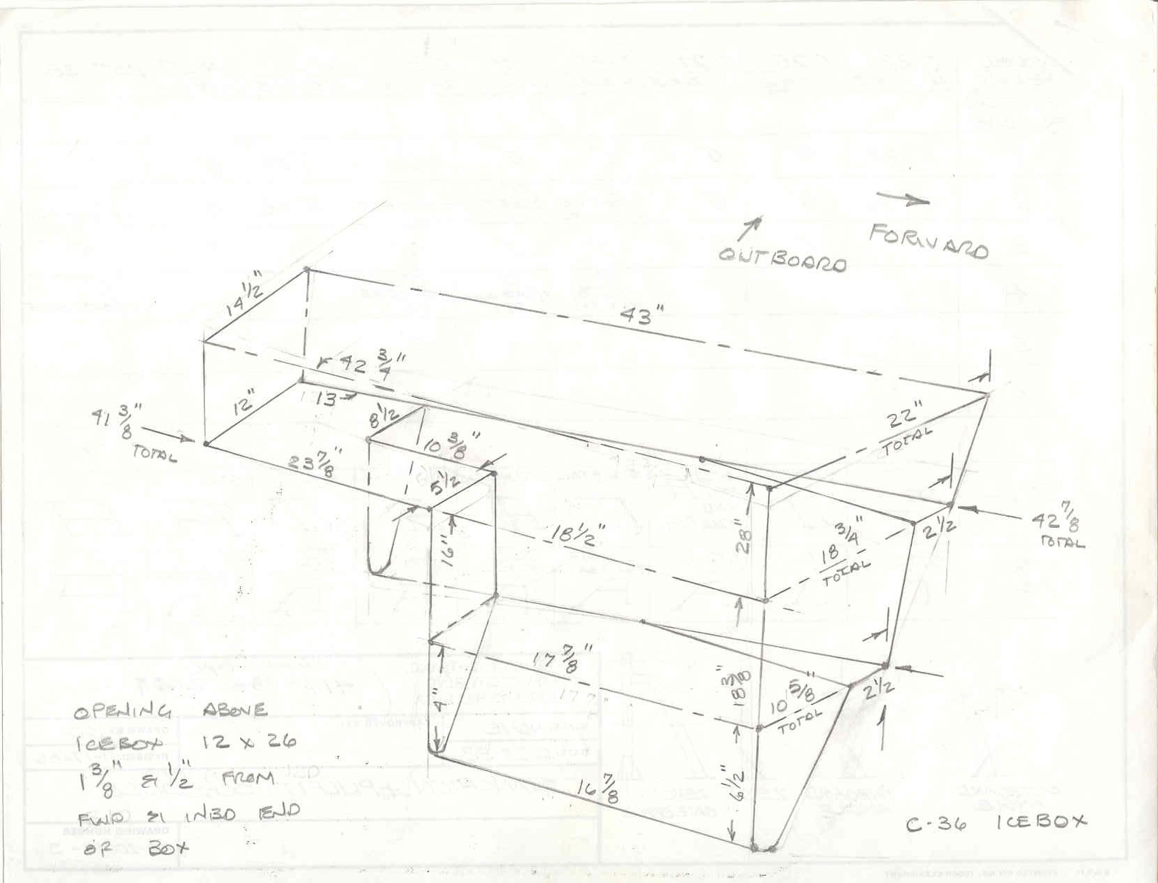

So I've been working with the SeaFrost Tech guy for two weeks to design an improved evaporator plate system for my existing fridge box. I wish there was someone out there who has tried something similar. Its a lot more expensive at about $1,850 than just replacing the Adler Barbour unit at about $1250. We are planning to use two 8" x 20" cold plates (not holding plates) positioned on either side of the area where the previous evaporator box was located. There will be a drop down door that separates this larger freezer area from the rest of the fidge. The 20" length of the cold plates will stick out past the door against the sides of the box to help chill the rest of the box. If it works, I will have a much larger freezer compartment, better cold flow to the rest and not consume much more power as the SeaFrost claims to be much more efficient than the Adler Barbour unit. I'd appreciate any comments or advice before I write the check.
(also see the great isometric drawing that Catalina supplied - great support from those people.)
