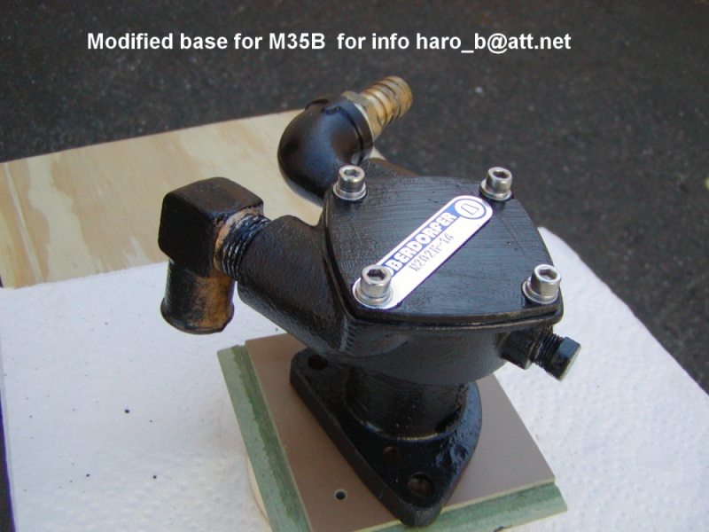

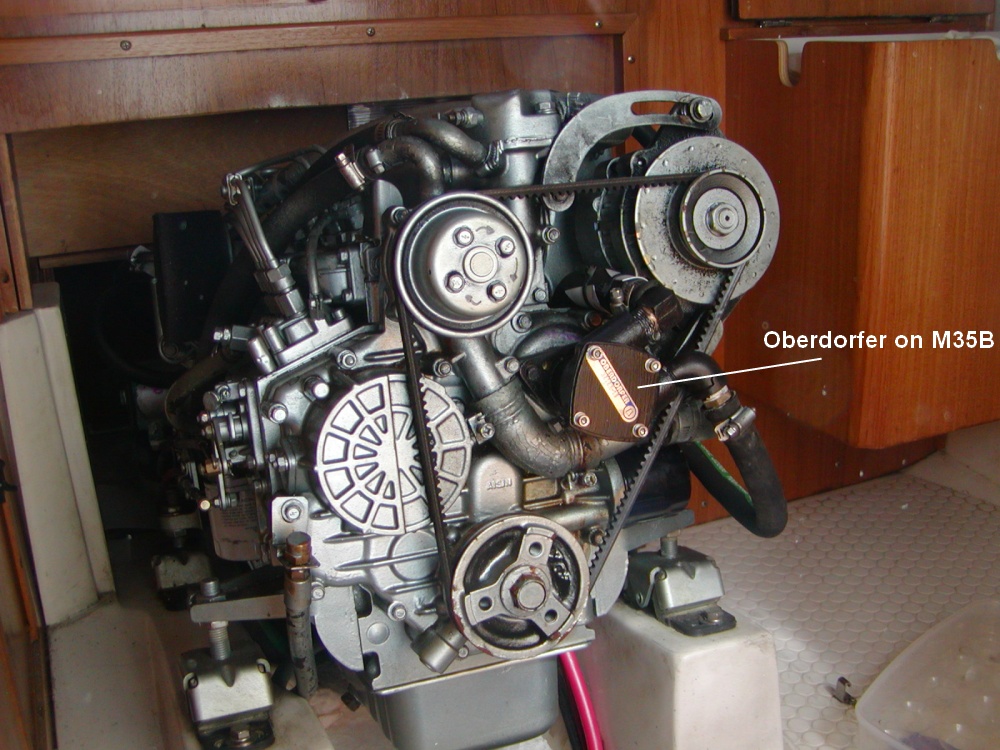

After failure of 2 of the $ 400.00 Sherwood raw water pumps at about 100 hours of use - I decided to move to a$ 220.00 Oberdorfer. No more leaks. If you need images of how to modify them and where to buy them send me an IM - if you are in USA I will send you all the info you need.

The process to modify an Oberdorfer pump to replace the Sherwood on both the M35A and M35B was documented by Randy Sherwood and Nile Schneider in a JibSheet issue in 2010. I've pulled that part out of the JibSheet and put it into the upgrades section of the main website.
[url]http://www.c36ia.com/node/2329[/url](link is external)
Having just finished this mod in the fall I can vouch for it's relative ease of completion and definite ease of future impeller servicing!
[QUOTE=HowLin;21553]Having just finished this mod in the fall I can vouch for it's relative ease of completion and definite ease of future impeller servicing![/QUOTE]
It's even easier on the M25 engine. A straight swap. Just check the studs.
