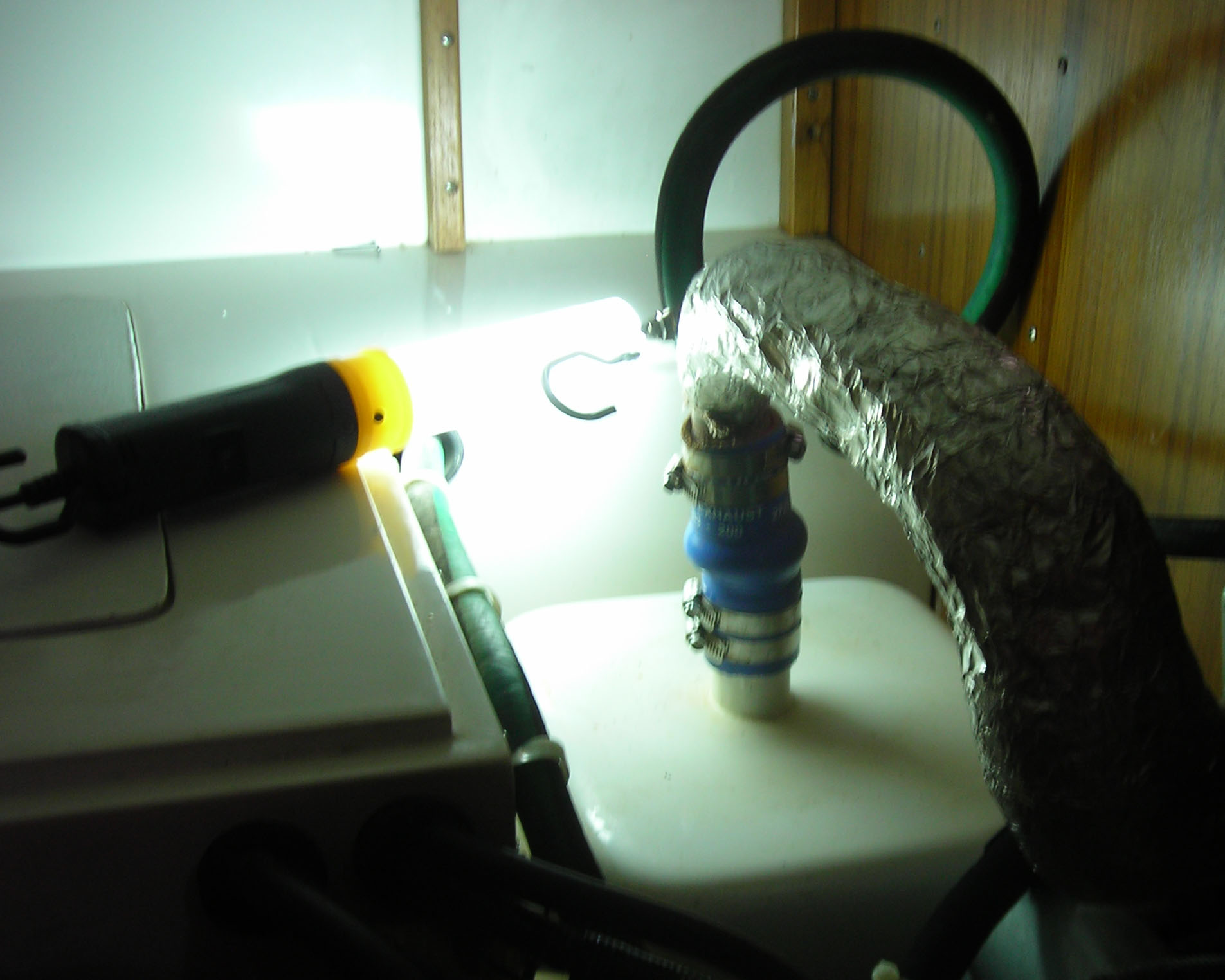

In your photo you show a blue hose going into the muffler from a hose wrapped in what appears to be foil. The foil wrapped hose on Caprice is wrapped in a white material and I am guessing that is the same hose. The blue hose you show in the photo is not the same as on my boat. My boat has a straight black hose with no buldge. Could this black hose not be the correct hose that belongs in the place of the blue hose?
What appears in my photo to be wrapped in insulating foil is not a hose; it is a cast iron or stainless steel (depending on age of boat) riser, which is a metal, very rigid 'duct' or 'pipe' that carries exhaust from the engine to the muffler. At the inboard end the riser is hard mounted to the engine. At the other end of the riser, farthest from the engine, there is a small tube joining into the riser. This tube is where the water from the heat exchanger enters, and is mixed with, the exhaust flow. Then, the output end of the riser mates with a large diameter hose to connect to the muffler. Ideally, this large diameter hose (a stiff, straight black hose on Mike's boat) should be a hump hose.
A hump hose is the proper connection to the muffler because it has a 'longitudinal flex' (the hump) that isolates harsh engine vibration from the muffler. Any boats with the stiff, straight black hose should certainly be retrofitted with a hump hose. The noise and vibration level in the boat when motoring will improve significantly if a hump hose is used. I purchased my hump hose (plus a spare) from Catalina Direct.
Rich's water leak could be at one of several points in this area, listed in order of probability: 1) Most likely, it is in the hose that runs from the heat exchanger to the mixer inlet on the riser. In my photo, this is the green/black hose that curves around in the upper right corner of the photo. Of course, the leak could be at any point along the length of the hose, so a leak may not be immediately visible just near the riser. 2) Less likely, the leak could be in that straight black hose, as on Mike's boat, but I think one would be aware of exhaust leaking if that hose were damaged. 3) The leak could be in the riser itself, I suppose...but not likely. Again, you would probably be aware of exhaust leakage. And/or 4) it could be a damaged muffler, but exhaust smell might be noticeable in this case also. (Caution: I needn't say this - but I will anyway - that any exhaust leak is dangerous.)
The system is fairly simple; it's not rocket science. Troubleshooting & repair, and installation of a new hump hose, are probably well within the abilities of the average do-it-yourself-er. Access on my Mk II is straight forward; but the Mk I boats may have more difficulty. Mike's 1990 should be similar to mine, I think. Rich's hull #1670 ditto. Any Mk I owner considering a similar problem on their boat should ask Steve Frost for insights, 'cause I don't know those boats' layouts.
I hope this helps.
(BTW, the reason my photo is blurry is because the engine was running when I took the shot.)
