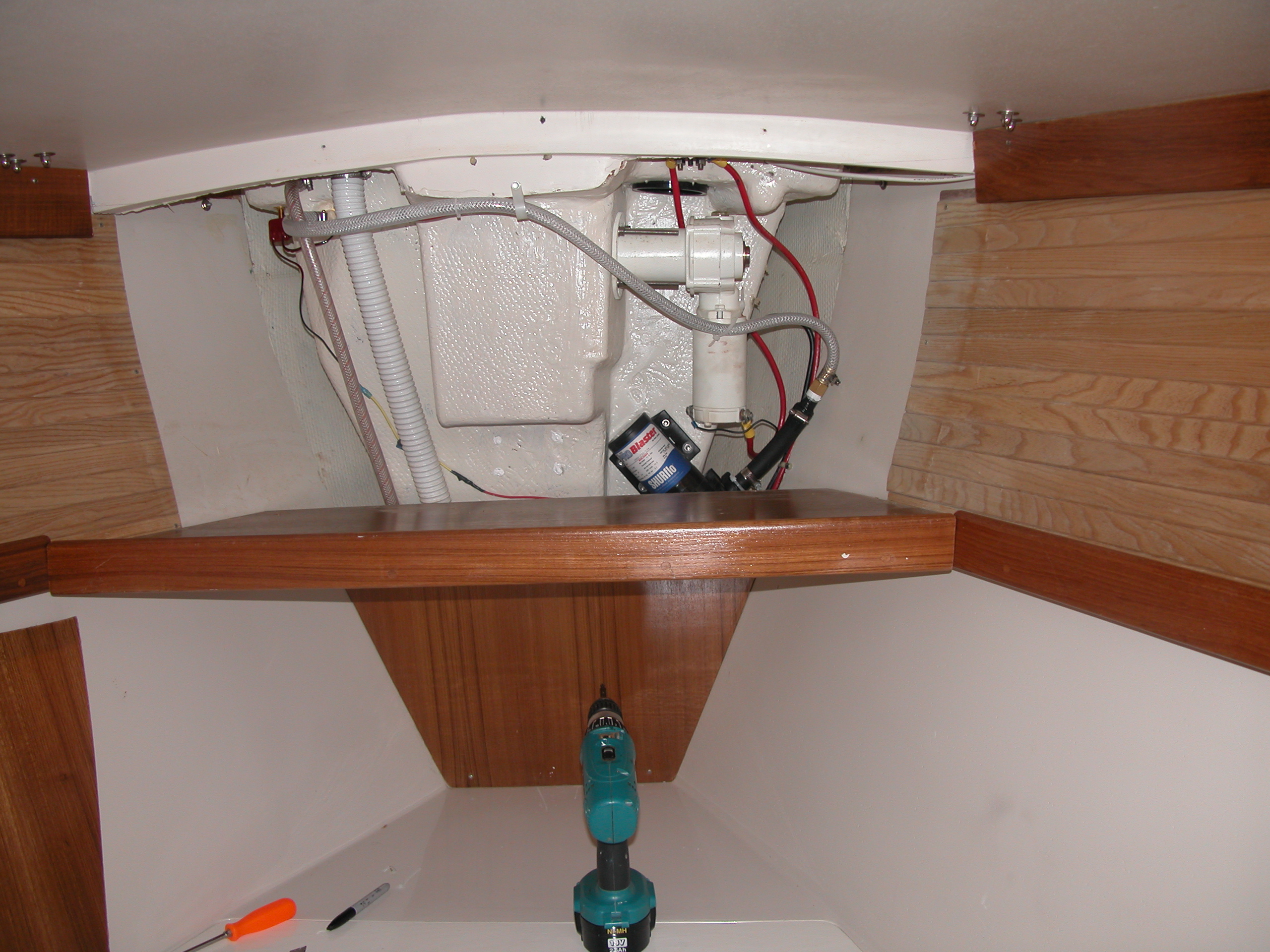

William Matley's picture
William Matley
Posts: 167
I put my pump here.
There may be better places but this is my solution.
Bill Matley
Cheboygan, Michigan
Lakes Huron, Michigan,
Canadian North Channel
"Spirit of Aloha" Hull #1252
