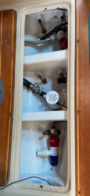

Joe
Joined: 5/19/20
Posts: 10
Wow!  Your bilge is beautifully clean.  What's your routine for that?

Zefyros
Joined: 5/8/15
Posts: 13
Thank you.
3 drips per minute :)
I stopped all leaks. The top of the mast is sealed as well as possible.The mast hull entrance is tighter than the keel itself. If there there is condesation in the bilge, I vaccum it out. I wipe any residue and repaint every few years. My OCD is not hurting the situation either :)
