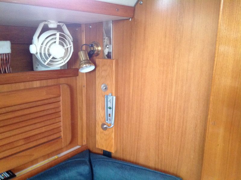

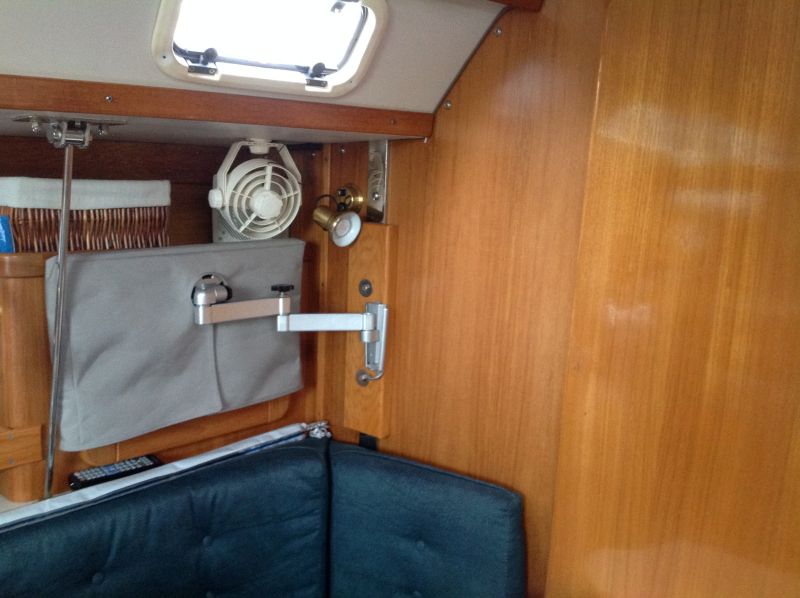

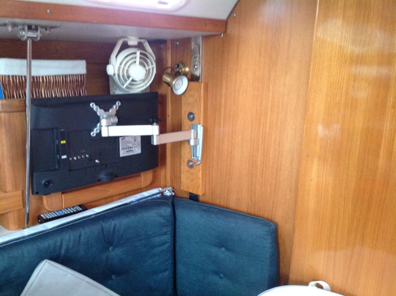

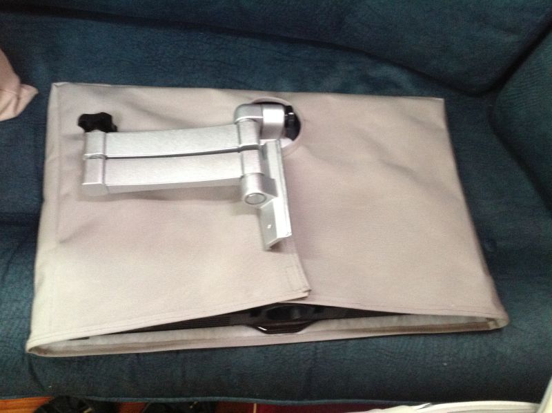

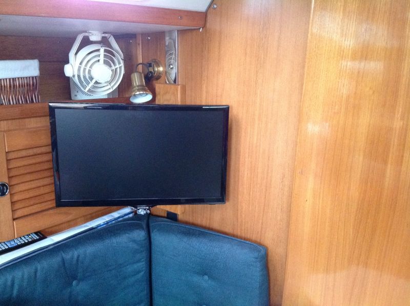

I added a 22 inch Samsung TV, without making any new holes in the boat. I made a wood block (oak) to fit over the chain plate and replaced two of the chain plate bolts with longer ones. On oak, Old Master, Gel Stain, Maple 81216, brush on wipe off, matches the teak quite well.
The bracket arm lifts off the bracket shoe on the wood block. The TV can be stored away or folded against the cabinet door.
