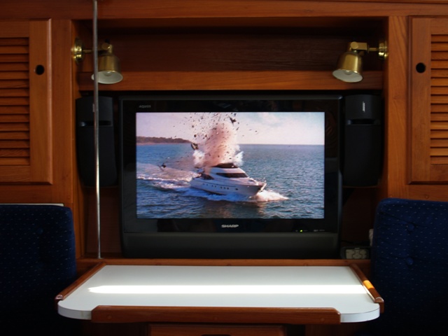

I installed a 26" flat panel on Deja Vu. I use a digital decoder box and a generic Best Buy digital antenna which is mounted in the aft cabin. There's also a DVD player hooked up to it and an HDMI cable so I can output my laptop to it.
[ATTACH]539[/ATTACH]
