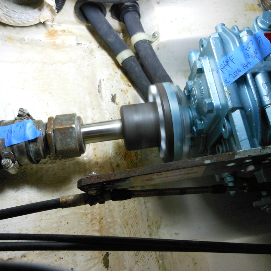

Got an infrared thermometer recently (they're cheap nowadays) and used it to find out how my new Teflon packing and my newly overhauled transmission were running. The packing was adjusted to almost no drips...maybe one drip every 5minutes. After running at 2000 rpm in forward gear in the slip for almost 2 hours, the temps stabilized as noted below:
The temp of the shaft log was measured on one of the flats of the packing nut. The temp of the transmission was taken on the case immediately beside the filler nut.

Have not yet written it up but I connected a temp sensor directly to my stuffing box for the entire 6.5 month season and 1100nm. The one BIG thing I discovered is that these temps are NOT static. I suspected as much but dd not realize how randomly they would spike up..
My guess is that as you move water gets sucked out of the shaft log and is replaced by some air bubbles or when you hit reverse some air gets trapped up in there? This is probably why PSS had soo many issues with entrapped air and the need to burp more often than just upon launch and why they added a vent to ALL PSS seals. My C-36 was a boat that needed chronic burping before vented seals.
With the box having no drips I could start out running at 75-90 degrees for 20-30 minutes then watch it gradually climb to about 130-140F. Next thing you know the temp is over 200F. I repeated this over and over and over. The packing was adjusted VERY, VERY slowly and broken in very, very slowly and there were three rings. The rings were "bench packed" to be sure it was absolutely perfect.. The bottom line is that SOME dripping was the only way to prevent the temp spikes.
If I had just hit it once or twice with a pyrometer I would have seen good results and not thought anything of it. When you have a digital gauge in the cockpit staring you in the face for 1100 nm you tend to see a lot more.
I finally got it down to about 1 drop every 2-3 minutes and that kept it from "spiking" after a while. No drips=spikes to well over 200f. I once saw it at 222F confirmed with my Raytek Pyrometer.
To eliminate false readings or screwy test parameters this was new Gore packing, a brand new Buck Algonquin box and brand new 1" AQ22 shaft. Boat gets hauled in a few days and I will yank the shaft and inspect, as it got damn hot a number of times when experimenting with no-drips..
