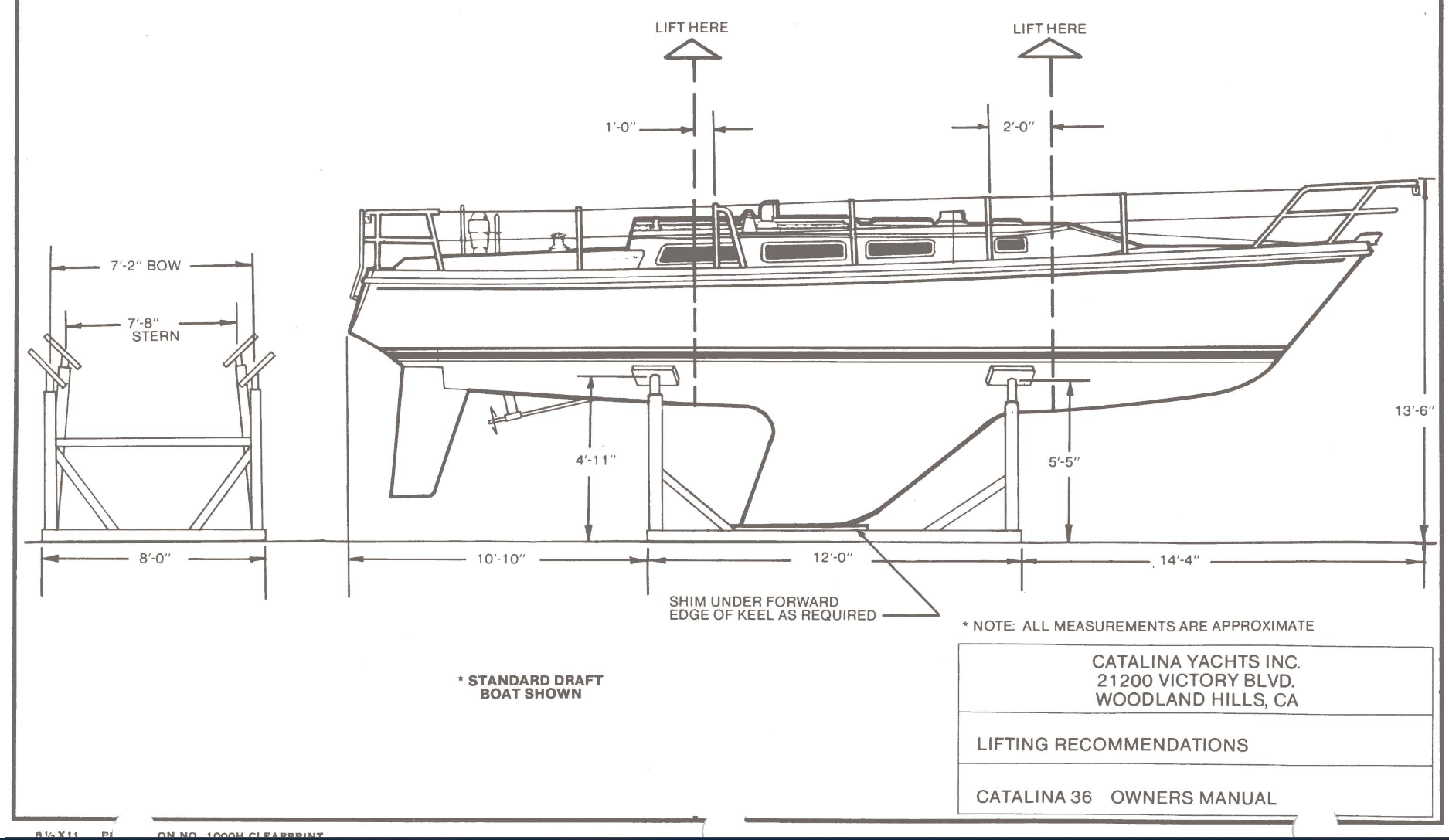

Thirteen feet six inches for the standard keel per the owners manual.

High school math applied to the numbers from the owners manual tells me, that the height of our MKI from the bottom of the wing keel to the top of the cabin / pulpit is 12' 2". But that is based on the regular draft number on the diagram in the manual, that also has a little support under the keel...

So to close on this if anyone else has the issue: I measured while on the dry... The height from the bottom of the shallow-draft wing keel to the top of the pullpit for my 1988 MK1 is 128 inches.

The Catalina 36 MkI Owner's Manual (p56 on the scan I have) shows the lifting recommendations.  That shows the height from ground to top of the pulpit as 13'-6".
Steve Orosz
s/v RIngle
1985 Catalina 36 Mk I #358
San Francisco Bay
Posts: 441
I was able to extract page 74 of the owners manual listing the dimensions of the C36 and its lifting points.
