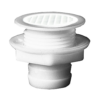

Ok, I looked up flush mounted thru hulls and attached a picture of what I found on the internet. In the picture, the flush mounted thru hull still has a side that is flanged on the water side of the hull to give it strength. I have nothing on the outside at all. From the water side, I have to put my pinky about 1/3 inch in the thru hull hole before I touch any thru hull material at all. Is it common for the flush side of the thru hull to break or fall off, or are there thru hulls that have no mushroom or flush flanging on the water side of the hull? I'm thinking I might be dealing with something dangerous here.

Posts: 740
Joel-
Make sure you have some tapered wooden bungs that could plug a hole if needed.
Is your flange nut on the inside of the hull loose?
If you can rotate the thru hull / valve back and forth- or rock it - check to make sure the flange nut is snug.  Any leakage or movement that continues with a snug flange nut - well, if I were you, I'd pull the boat and examine closer what's going on. This time of year is typically slow for the lifts in the marinas and you should be able to negotiate a resonable price to haul out for a few hours and then drop back in.

Joel,
I can't comment on the slow leak, but as far as the other thru-hulls, I think you are getting all worked up about nothing. Here's a link to the type of thru-hulls which have been installed on Catalinas for many years (Forespar). The pic you posted above is a skimpy plastic fitting to be used on a baitwell or similar. You do not need a mushroom fitting to provide strength. With a properly installed flush marelon (not plastic) fitting, including a backing plate, you should have no problems.

The 93-series of Forespar valves primarily depend on the pull from the through-hull.  If your king nut (valve flange) turned, then the sealant between the valve and the skin or backing block has failed.  The Forespar flush-mount through-hull provides much more strength and contact area than the nylon scupper you show in your picture.
At some point, you're going to want to re-bed the entire assembly to bring it back to proper installation practices, i.e., a good bond between the king nut and the hull.
http://www.forespar.com/pdf/93SeriesValveInstallation.pdf

What I'm saying is whether it was a flush flange or a mushroom providing strength on the water side of the thru hull fitting, whatever was there, it is completely gone. There is nothing, not even a remnant on the water side of the thru hull. All that is left is the part that screws inside the hole in the hull, and I have to put my finger about a third of an inch inside the water side of that hole before my figure touches what remains of whatever was originally installed. So unless there are thru hull fittings that are made with no flush or mushroom flange on the water side, it would appear mine broke off or disintegrated. That is what had got me worried. Now if you are saying there is nothing to worry about if that part of the thru hull fitting is no longer there, or that my thru hull fitting was likely made that way, I'm all ears.

If the outside mushroom head or flush mount flange broke off, wouldn't you have seen an area with no bottom paint when you dove or when the boat was on the hard before launch?
I think some thru hull flanges are seated in a countersunk depression on the hull exterior. With bottom paint build up, this could give the appearance that the flange is non existant. This might be what you were seeing when you dove to take a look.
Bottom line- if there is any water seeping in, or you can create motion by rotation or rocking the fitting from the inside of the hull, the boat should be hauled

Let's see.  (1) no flange or mushroom on the through-hull, (2) just a broken stem inside the hole, and (3) the seacock flange turns.  If all true, then you should at least get a short-haul ASAP and investigate.
When you're hauled, since the seacock turns, you might be able to leave the through-hull as-is and unscrew the seacock from the inside of the boat.  Once you do this, there should be the threaded portion of the through-hull exposed and you should able to coerce this out.  At that point, install a new through-hull (Marelon) following the instructions I pointed to in my earlier post.  This is not for the timid, so there's no shame in contracting the yard to do the work.

Thanks for your reply, Paul. There are what look like little round depressions in the hull around the thru hull openings. These depressions are covered with the same bottom paint as the rest of the hull below the water line. It didn't look like they were painted over flush flanges, but rather round depressions where the flush flanges would seat. It's possible the flush flanges have been covered up by the paint, but I doubt it, there were no seems at all as far as I could detect. I will dive on the boat again and see if I can see any sign of what you are talking about.
As for the yard missing them, that has got me perplexed as well, and makes me think that what I'm looking at may be "normal". Nobody mentioned it when the boat was hauled out and surveyed, and nobody mentioned it when my boat was hauled out and bottom painted either. As for me, other than blisters and bottom paint, I had no idea what else I should be looking for when they hauled it out for the survey.
