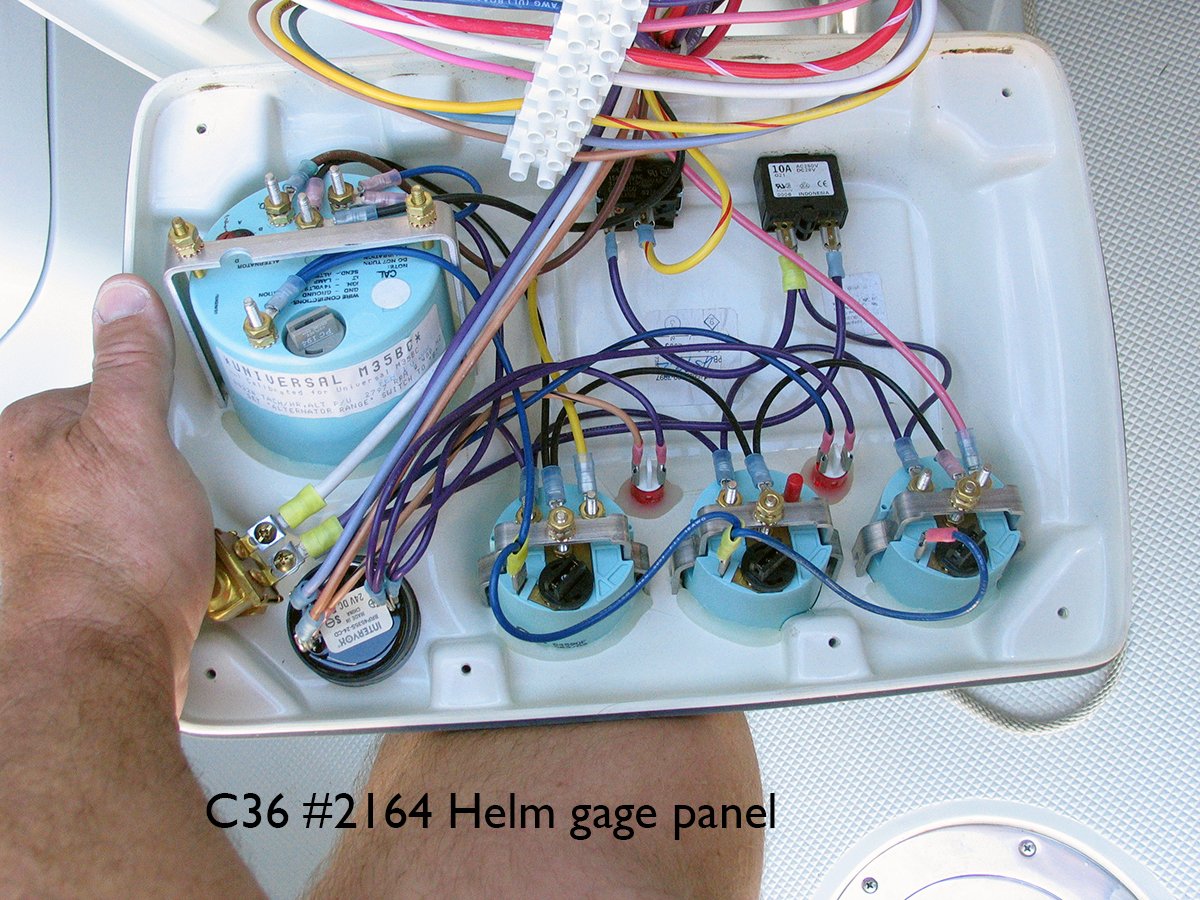

Greetings sailors - C36 #2164 MkII  2003 model year:
.  My engine temp gage has been showing 180 deg when cruising.  I've tried and tried to find the cause. 1) Removed the HX  Heat Exchanger boiled out, repainted. Replaced, checked hoses, replaced two.
2) checked the raw water thru hull for clogs.
3) replaced the thru hull to strainer hose
4) check the raw water strainer
5) replaced the thermostat
6) replaced the temp sending unit, checked to make sure the elect connection was intact
7) changed the raw water pump (finally) to an Oberdorfer
​8) even bought one of those cool infared temp gages, read about 160 deg at the thermostat after warming up to running temp.  Odd I thought.
​Still the gage reads 180 deg!
I decided to boil a pan of water, insert the removed temp sending unit (with connection and ground) into the pan of water with a digital thermometer   With the ignition on (engine nor running of course), and as the water slowly cooled in the pan with the sending unit, my wife read off the helm gage.  I compared to my digital readings of the cooling water in the pan.
Results:  The temp gage was reading 20 deg too high!
Before I replace the temp gage and a calibrated sending unit, I want to ask this group if temp gages can be adjusted.  Thinking the back side may have an adjustment screw?  Thoughts?

Why not remove the gauge and wire it directly to the sending unit with an external 12v battery. This will check if there is a bad connection wiring on the boat. I would do this at home, that is completely independent of the boat. Use kitchen thermometer in the heated water to check accuracy. If you decide to replace the gauge, repeat this test before installing to confirm that you have located the problem.

In 2015 I bought my 1989, and found the temp gauge reading 200+. I used a heat sensing gun/sensor and it read 180 at the thermostat housing. The wiring from the engine compartment to the cockpit gauge panel was corrroded. I rewired by running a thick red/black to the panel and a smaller multi wire for the other wires.
