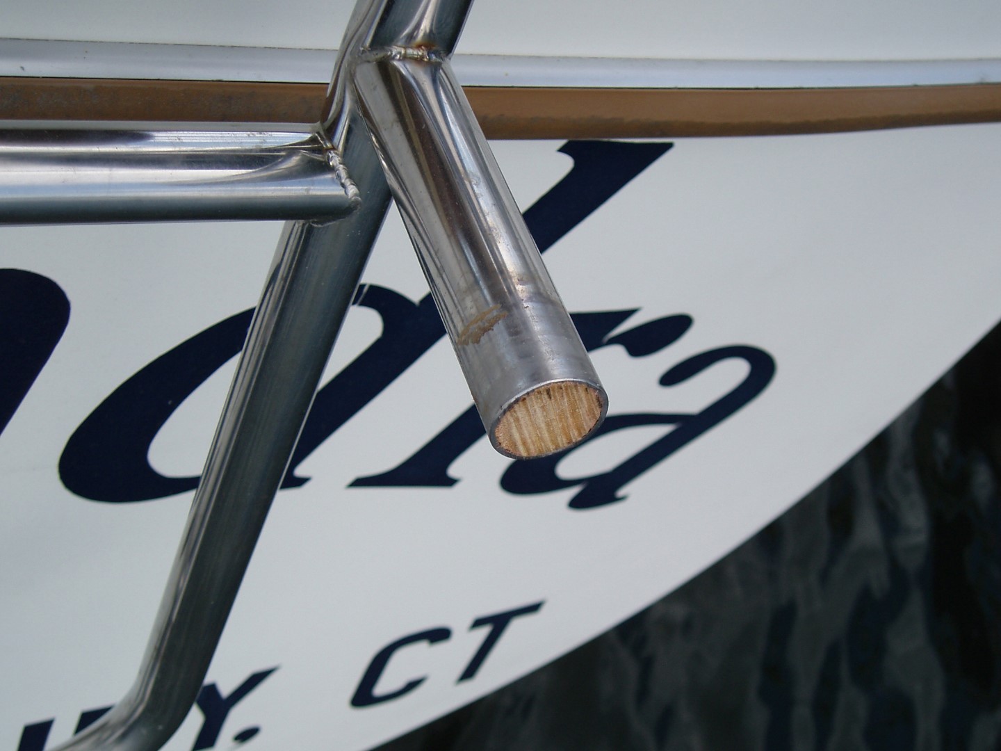

Wally,
I don't know if your ladder standoffs have an end cap welded on, but if they are straight pipe, with no end cap, I found that the ladder standoffs would cut into the rubber crutch tips in a very short time.  To prevent that, I jammed pieces of dowel into the standoffs (I think I used 7/8"?), and cut them off flush.  With the increased surface area, the crutch tips lasted longer.  Can't do anything about the UV degradation, but at least the ladder standoffs didn't cut through the crutch tips and ding the gelcoat.  Just a thought.
Image icon LadderStandoff (Large).JPG209.12 KB
