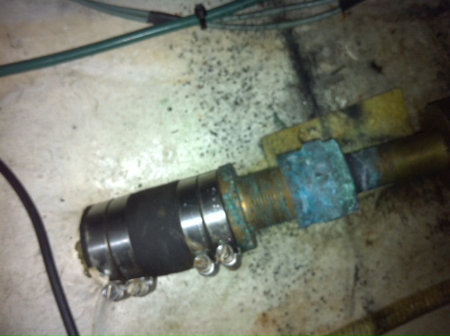

Hi, everyone.
In the attached pic, you can see my stuffing box. When I moved it from a freshwater lake to the ocean, I repacked it with gore-seal dripless packing gland, so it wouldn't leak salt water into the bilge, but as you can see, it has quite a bit of blue-green patina due to the salt on it.
Is that bad? Should I worry? Should I do something about it? Is it going to freeze up on me so that I can't adjust the packing nut?

No - it is normal. You do not have to do anything. You can clean it with fresh water and some scrubbing. Water must drip inside to keep the packing lubricated. That is normal. You probably did not notice the water that was dripping inside when you were on the lake since it contained no salt. I place a feminine pad below the drop to absorb the drips. Ask you wife for it!
Coyote Point, San Mateo, CA.
Ben, Haro's right. You can clean it up with a brush with bronze (not steel) wool. Then, if you don't have nay yet, buy some Lanocote. Back off the locking nut and slather the Lanocote on the threads and the matching faces of the locking nut and the box. [url]http://www.westmarine.com/webapp/wcs/stores/servlet/Product_11151_10001_...
There are lots of uses for this material.
Thanks, guys. Big relief.
I have lanacote already. Will apply some as you suggest.
