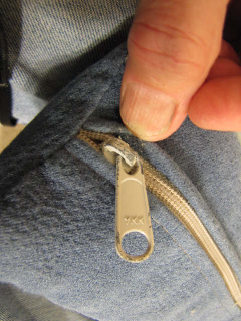

This is not a very technical issue but I didn't see a more appropriate forum and couldn't find help through "Search". The zippers on my cabin cousions are stuck. I need to remove a couple if not all of them for cleaning and they won't budge. The zippers are white on white cloth with some white powdery residue showing. I tried spraying with some dry lube that works on the canvas zippers, but it didn't seem to help. Any body had and solved this problem? I'm assuming these are the original cushions on my 1994 boat. They're in good shape otherwise.

Those are plastic coil zippers with metal pull tabs and are a little more fragile than your other zips. The white corrosion (from the metal pull breaking down) needs to be dissolved before they can be freed, as they are being 'welded' in place by the corrosion. Then you'll need to lubricate and try to remember to unzip back and forth once a year to keep from this happening again.
A little hot water MIGHT help in dissolving that corrosion...

I have thrown away plenty of seldom-used items that had that kind of zipper corrosion. It is very frustrating. I once tried WD-40 and it actually worked after a while. I am sure there is a better solution, though.

You might try a drop or two of PB Blaster on the white powder corrosion. That stuff works wonders for other types of corrosion.

I had the same problem, and ended up doing the following
1. Cut away at the metal of the zipper-pull with wire nippers until it fell to pieces.
2. Then unzip by just running a finger down the length of the zipper.
3. Remove the cushion, and turn the cover inside-out.
4. Replace the zipper-pull with new unit -- these are available from multiple sources on the internet. My zippers were "coil" variety 4.5 mm. Most zipper pulls will have a tiny number right at the top end that indicates the size.
---> Sailrite.com has several very good videos on zippers, zipper types, and re-threading new zipper-pull.
5. You will have to use a seam-ripper [any fabric store, or Amazon] to carefully open the stitching across the end of the zipper to place a new zipper pull in place.
6. Then resew just about 1 inch across the end of the zipper. I did it by hand, I don't have a sewing machine.
This was reasonably easy, and I didn't have to replace the entire zipper, and now the zippers all work perfectly. I suspect it was a lot cheaper than getting it done professionally.

I used WD40 and left them overnight - they all worked for me.

I cut the thin twine connection between the front and the back, and then when I put the foam back in I used whipping line, and ran it through the cushion between the front and back with large needle, and tied tight to maintain the tension the way it was originally. It was actually very easy. While the foam was out I washed in the washing machine with bleach. The cushions look great, smell great, and the zippers work. I have done my whole set -- a great winter project.
