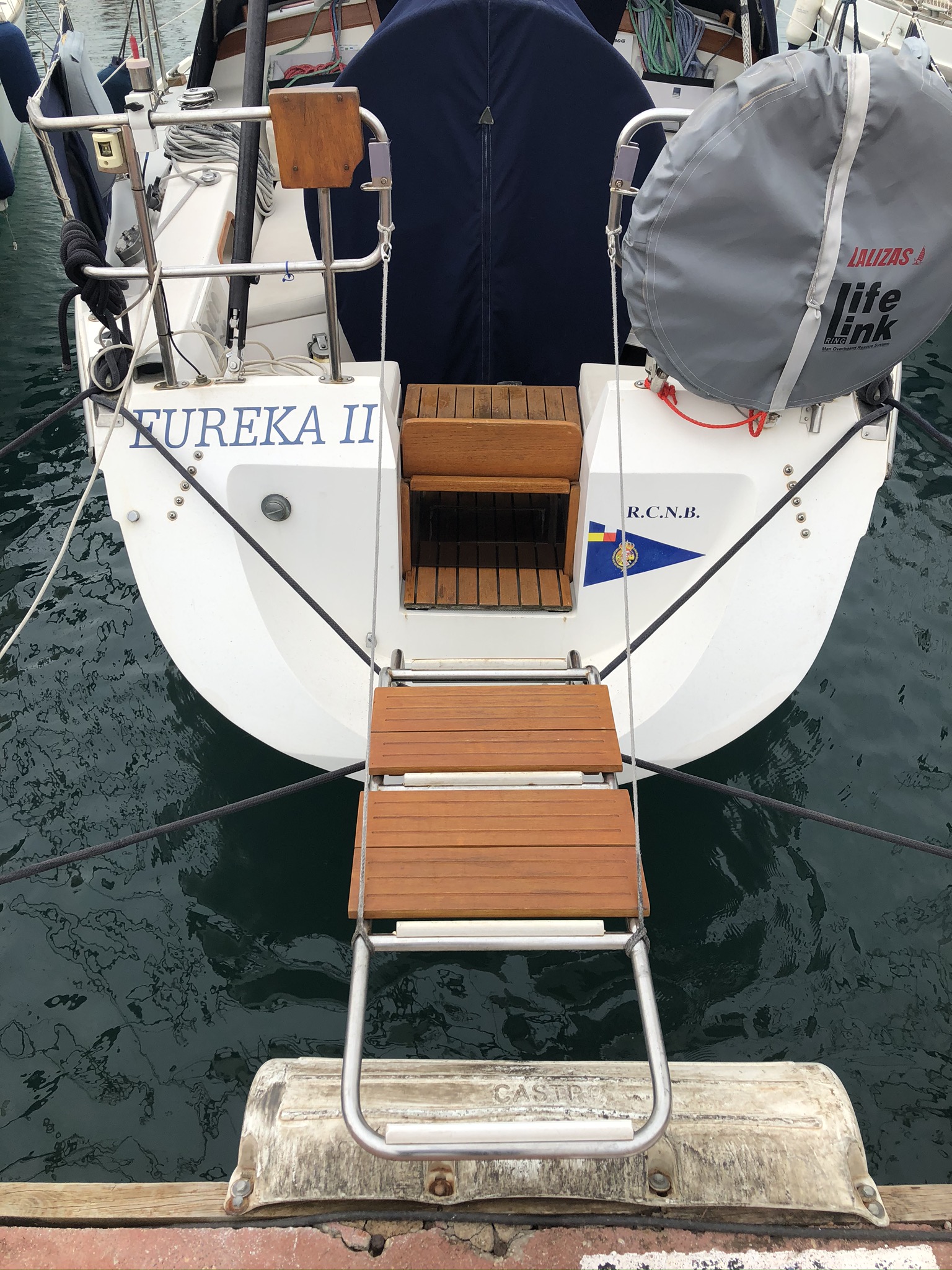

Hi,
I'm in the process of installing a gangway on my C36 MK1 open stern.
i have already order a light one made out of composite.
My idea is to remove the actual swim ladder and fix the new gangway on the open transom. I will add a foldable ladder on the swim plataform.
Also add 3 life lines (dyneema) to close/open the transdom.
Previously, I was using the swim ladder to access the boat. I added some remouble wooden plataforms between steps.
Will see how it works
