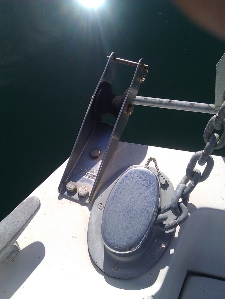

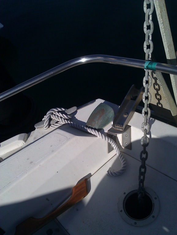

I have been planning this improvement too as I have a bow roller left over from my last boat. I took some pictures of a couple of my neighbors' boats.
The first one is a simple roller mounted on the transom outboard of the vent location. Has a nice hawser pipe to drop the rode into the lazarette, mounted in place of the vent. However I imagine it's a bit of a fiddle getting the line down there, probably not so much trouble with the chain.
The second and third pics are of another boat with a bow roller mounted over the transom but supported with a custom bracket made to fit the corner between the transom and gunwale. The rode in this one drops through a deck plate in the lazarette bench, not sure if I'd like having that much of an opening to the sea. Note on this boat the custom stainless bead along the lower edge of the transom to stop the chain from bashing against the hull. Made necessary by the fact that the roller doesn't extend outward of the transom at the transom's lower end.

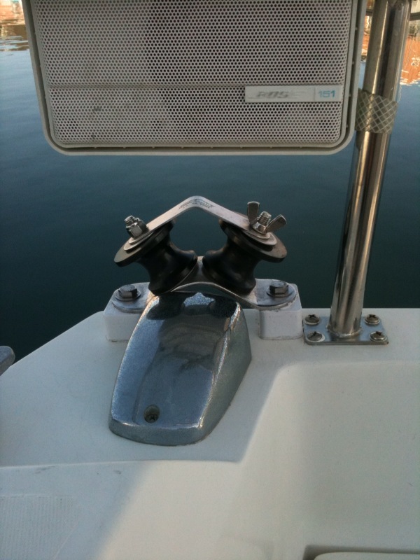

I just finished installing a stern roller on my boat. It is not like my bow roller, in that it does not extend away fron the transom. I figure to use it after dropping the anchor, to lead fair to my sheet winch. I will include a pic of it. I made little spacers out of epoxy and lots of glass to clear the vent.
Darn, I forgot to take a picture of the installed unit! I will get one this week and post it if anybody wants to see it. And I will test it sometime soon.

Mike and Bill,
Does that two-roller device take the load, or do you cleat off the rode?
When you raise the anchor, what do you do about the fact that you can;t get the rode out of the roller? I guess that would force you to hang the anchor off the outside of the rail?
Nick
Nick Tonkin
Hi Nick. The metal "strap" across the top is there to keep the rode from jumping, but it is easily removable with a wingnut on one side (see photo below). When the anchor is down, I prefer to remove the rode from the roller and fasten it to the stern cleat in order to relieve any sideways pressure on the roller. When raising, just drop the rode into the roller and lead the cleated end to a winch. The thing is through bolted with a backing plate, so you could probably just leave the rode in the roller while anchored, but I just dont. Hope that helps.:D
[ATTACH]734[/ATTACH]
I agree with what Mike says. I was planning on leaving it inside the roller when the anchor is deployed, but I will have to see.
Here is my installation. I didn't want to move the air vent, hence the spacers. Everything is super strong, as there are similar spacers as backing plates, epoxied in place.
I'll let you know when I finally "road test" it. :)
Cheers, Bill
