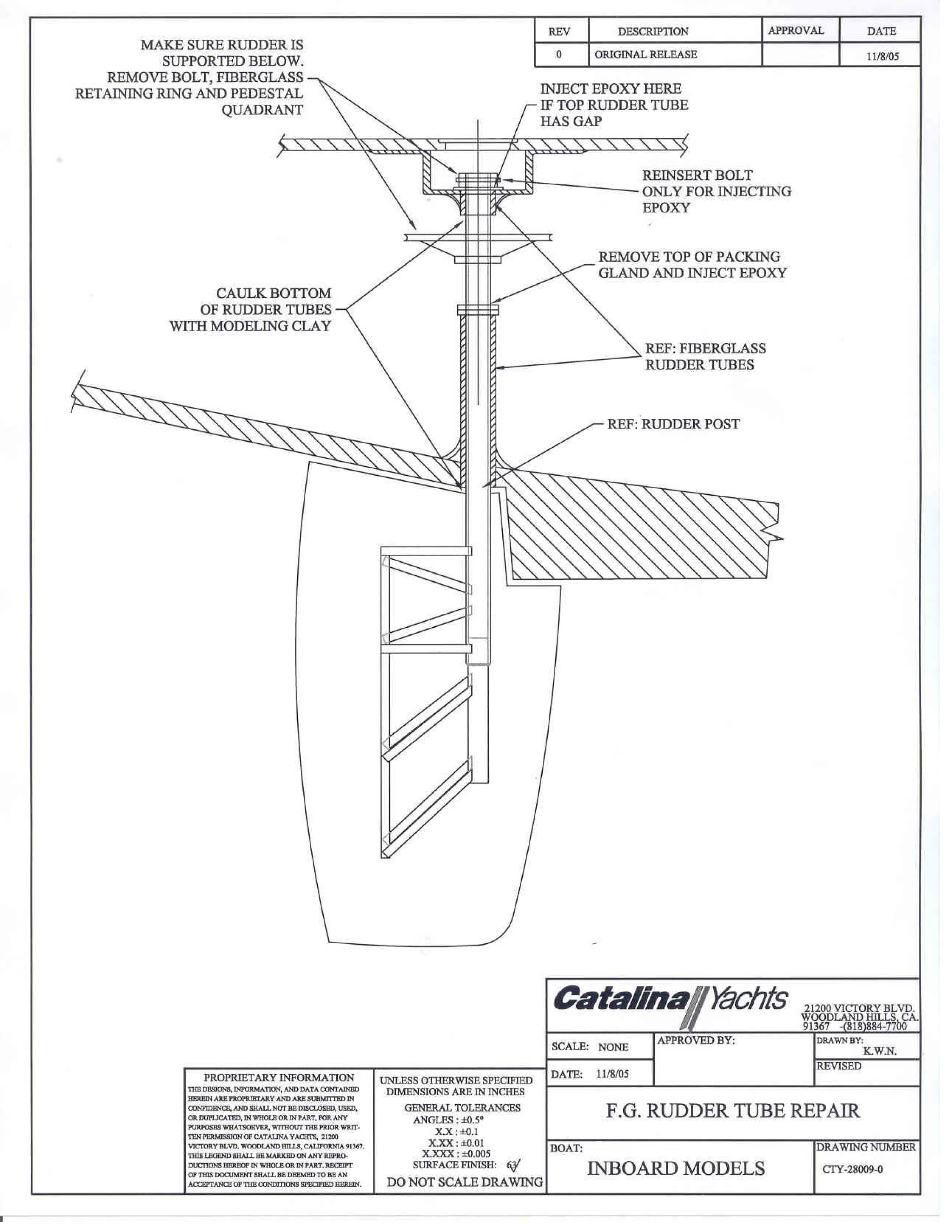

I searched "rudder tube" on this forum, and found a few helpful illustrations and photos, including this one of the rudder tube assembly.  I don't see any kind of bearing in this illustration.  I'm also not sure what this repair is showing - maybe the rudder tube is double-walled and thi sis showing how to fill the gap between the walls with epoxy?
Anyway, my first step is going to be to open the tiller hatch and inspect the large plastic washer under the emergency tiller head.  It sounds like this is prone to wear/breakage, so maybe this is the source of the noise I was hearing.

Erik, I've replaced our rudder.  There are no bearings of any kind, just the packing material around the shaft under the brass plate which you've been advised above to snug up the four bolts just to see if there is any room to tighten them (don't break them off!) and thereby snug up the packing material.  Check the entire assembly top to bottom.  The problem we had was that the stopper pads that are glassed in to prevent the rubber hose-covered post on the top of the aluminum quadrant from turning past the maximum rudder angle had been banged out of shape and therefore the cable attached to the chain up in the wheel pedestal had pull all the way up to the brass gear and had eventually gotten chewed up, separated and come off.  ALWAYS HAVE YOUR EMERGENCY TILLER READY!!!
The squeaking you're hearing might be from the post connecting with the stopper if it is happening when the rudder is at the max.  I'd also check the cable around the quadrant for sufficient grease.  Could be something is amiss inside the rudder tube, hence the repair suggested by Catalina.  I'd just keep playing with it to get your ear closer to where the source is.  I have cut the rear cabin wall from top to bottom and left the screws out so that I can remove the port side and slide back in the stern lazarette from the cabin to see under the fiberglass cover without removing it to adjust the cables and check for tension and grease.
