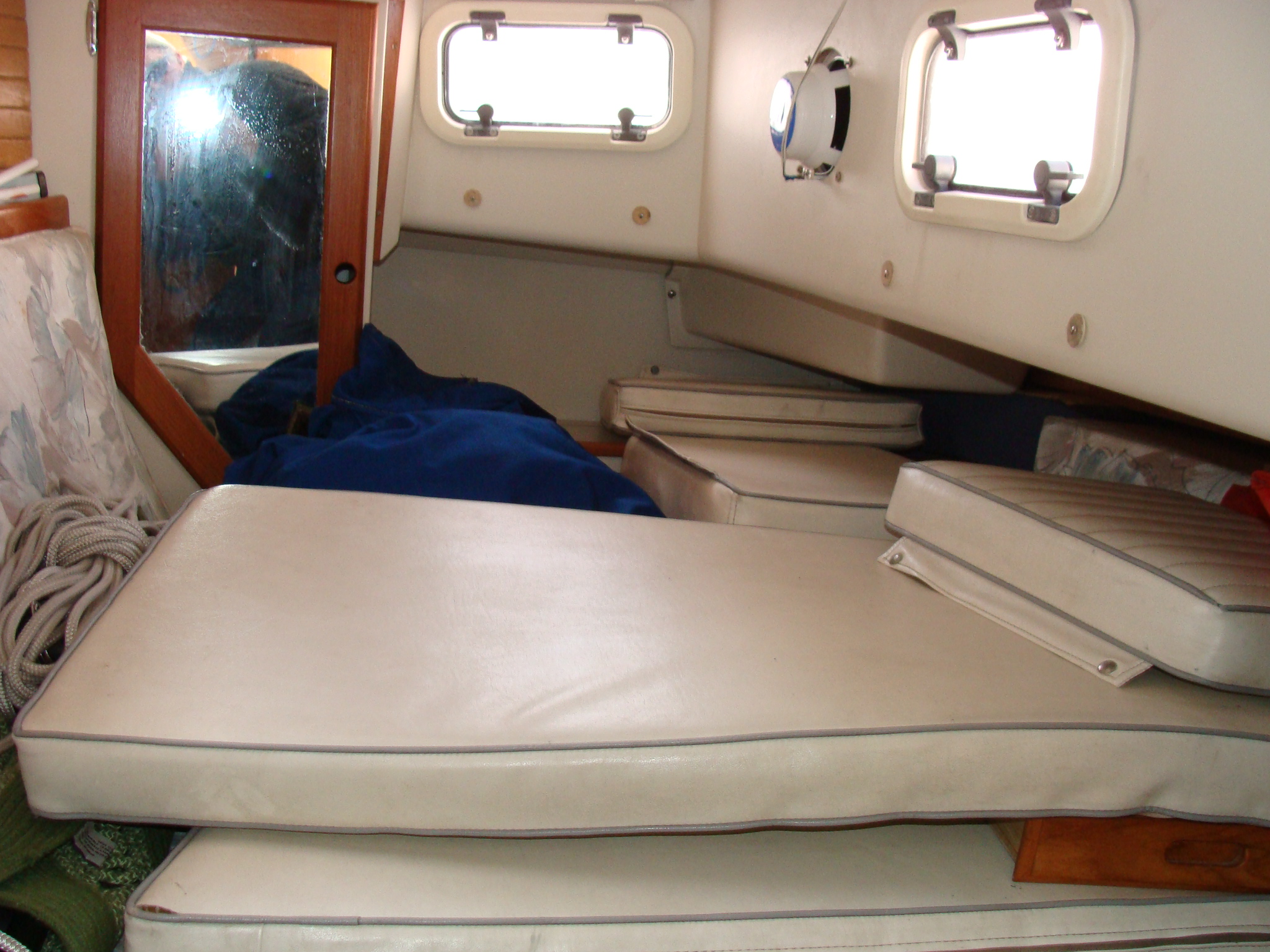

Thanks for the reply Gary but on our boat the aft bulkhead in molded as part of the hull liner with no way to remove and no opening except where the cables feed through to the quadrant. Pictures on this site show the MK 2 boats have a hatch on the port side on the bulkhead. See attached for a cluttered view into the aft cabin and bulkhead.

Well that makes it a bummer. Sounds like a good idea to design your own access.

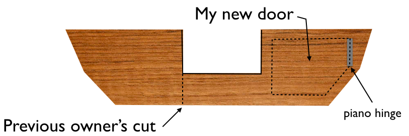

#2.  Can't understand why Catalina worked so hard to make that stern cubby space inaccessible, but they stepped it up in your '93 version by glassing it in!  On our '91 there is a screwed in teak plywood panel back there.  I have no photo and the aft cabin is now filled with stuff for the winter, but I'll do a drawing and attach it.  The previous owner made a cut on the starboard lower side of the panel below the fiberglass box and left out the screws so that, when I made the change to the aft berth cushions (see earlier 'how-to' post) and ended up with no cushion in the aft foot and a half of the cabin, I could simply wiggle the port side of the panel out from under/behind the cover-box to access that cubby and store things we rarely use.
#3. See screenshot below.  I then went a step further and re-attached the cut panel with screws and cut a new access door, adding a piano hinge and latch to hold it in place.  The access is more restricted than with removing the entire half panel, but it is easier and I rarely use the stuff back inside there (bouy and chain to rescue wedged anchors, inflatable bouncy ring to pull behind the dinghy for kids, etc.).
I really suspect that you will need to cut a permanent access panel back there, Gary, perhaps as large as the entire port side panel I have, but the only way to get started is to first remove that cover-box over the quadrant.
