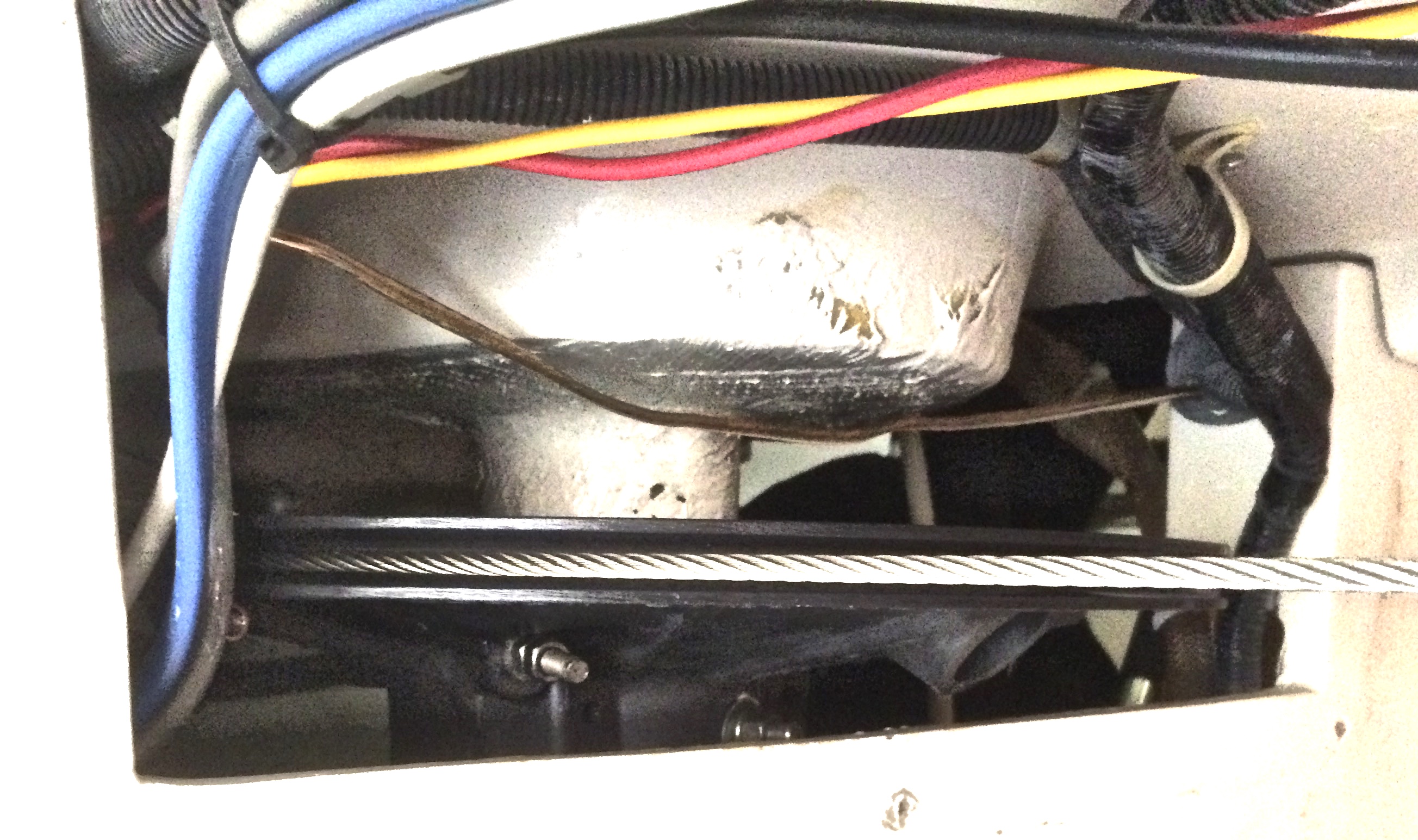

I have one more question to throw into the mix. Has anyone created a second access pannel in the aft cabin to better access the cables and the tensioning nuts? Our boat has a removable wood pannel on one side of the rudder post but not the other, requiring very akward arm and body poistining to loosen the cable tensioning nuts. I think I tried hanging upside down in the aft seat lockers and that didn't appear to be a good approach either. Maybe it's a two person job? There is not a wide enough opening below the quadrant to get a socket extension on one nut and a had wrench on the other nut.

Paul,
I ran into the same problem, I could reach through the Port side access panel and tighten the locking nut on the Port side but for the Starboard side I had to squeeze down into the Aft starboard locker. I am 6' and 195 pounds so I just fit!. I remove all stowed gear from both sides before taking the plungs since I have to stretch out my legs across to the port side in order to duck down low enough to get to the locking nuts. I do think there is a specialty wrench that you might try that is a open end that you can turn up to an angle and get a socket on the locking nut. to avoid crawling down the locker in the future I thought about buying something like this:
