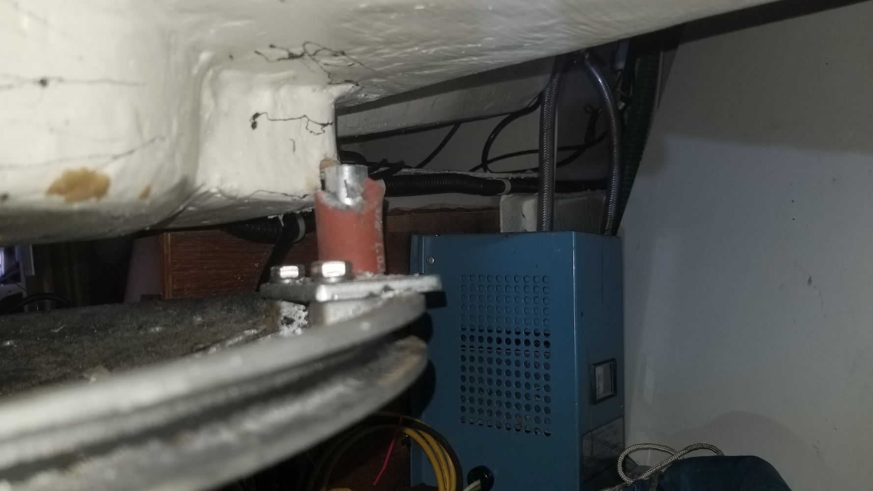

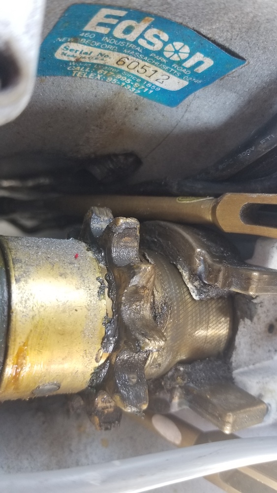

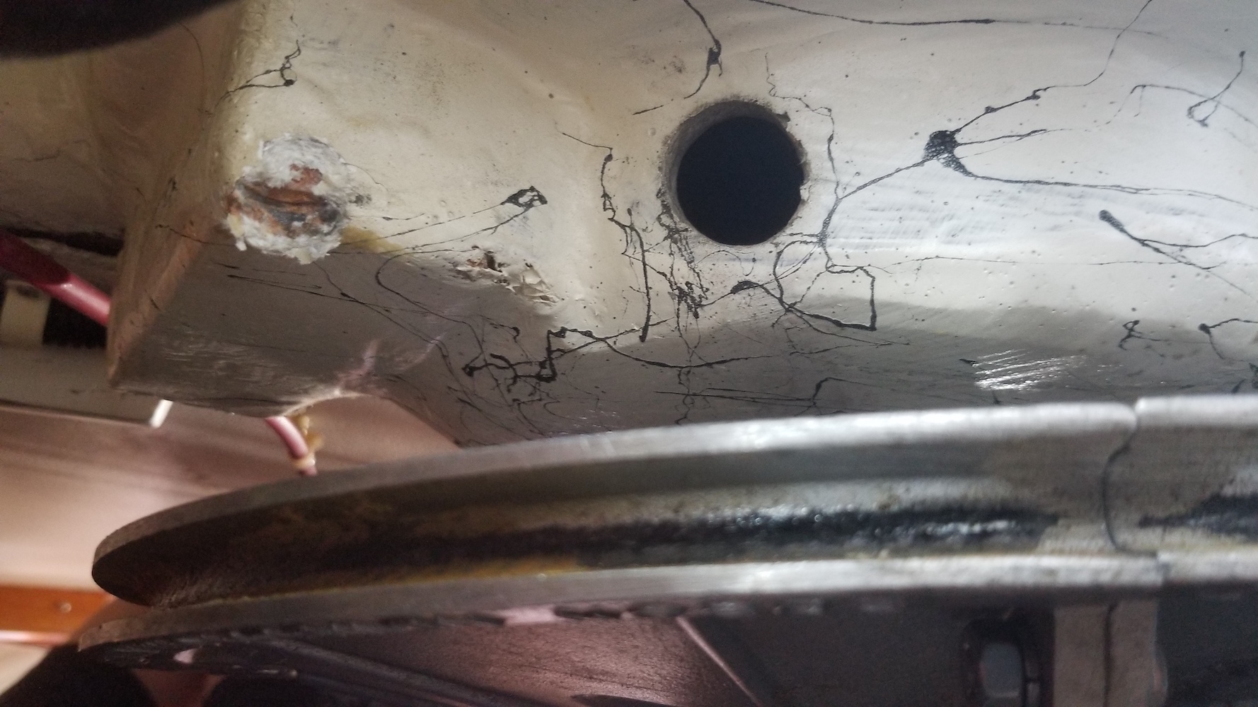

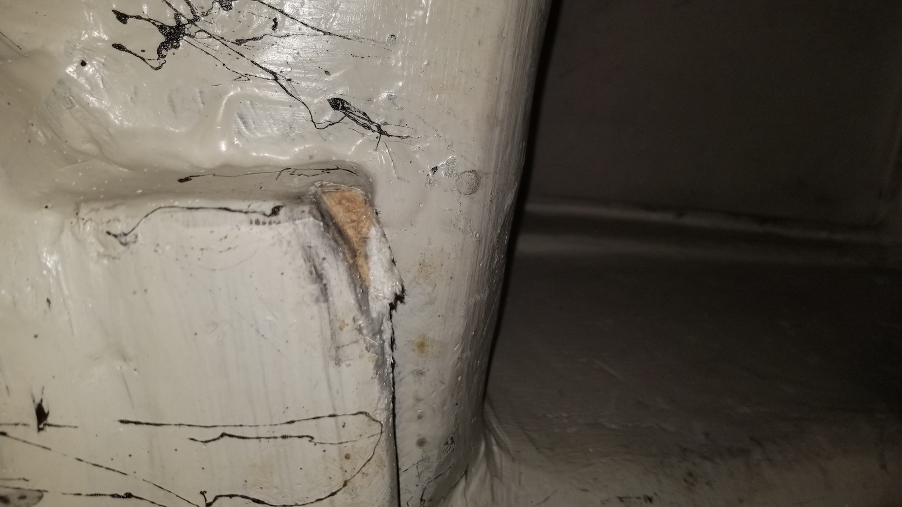

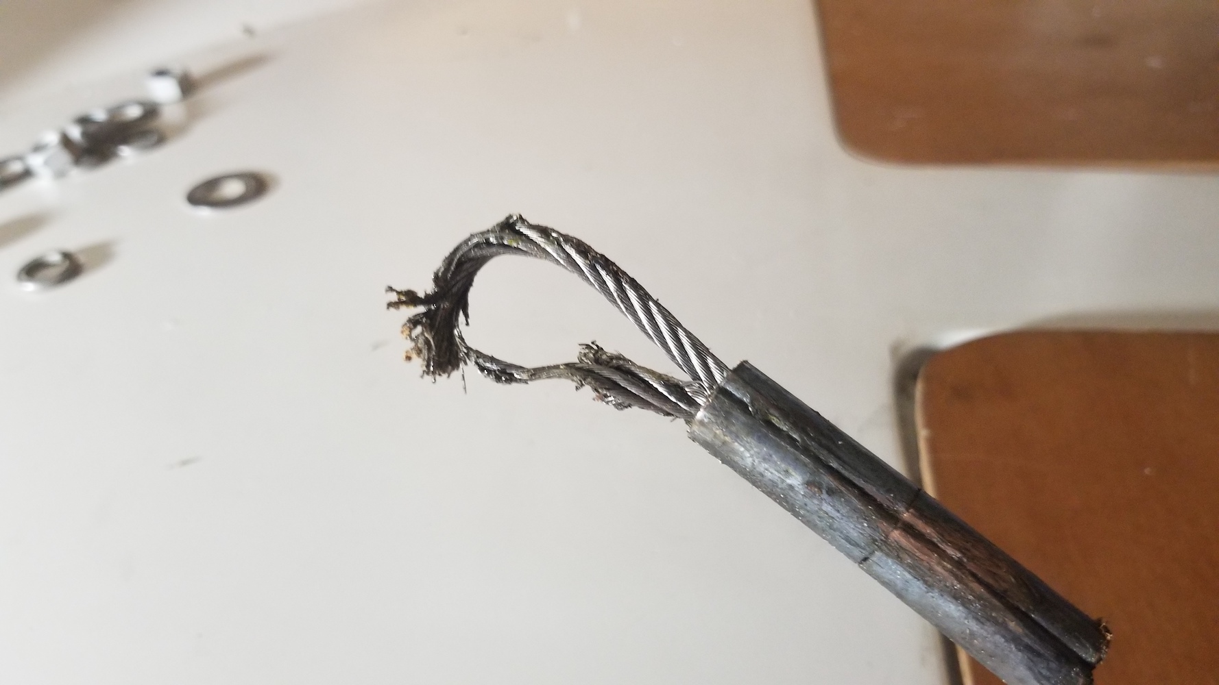

WARNING for all owners of circa 1991 C36 (possibly all models).  Very poor design of steering quadrant limiter post 'stops'. Yes, we had a grounding which might excuse a portion of this complaint, but please look at the photos I'm attaching and check your vessel.
The metal limiter post that stands erect on the aluminum quadrant should be covered by a piece of exhaust hose to minimize the 'clunking' when it bumps up against the stop when turning the wheel hard to port or starboard (see photo #2).  On our C36 the fibreglass 'stop' that the post is meant to hit squarely was not wide enough.  The post had been hitting it on the corner and too low, wearing the rubber off of the post and gradually chipping the fibreglass away so that the post was sliding past where it was meant to stop (photo #1).  This allowed the wire at the terminal of the starboard control cable to come up incrementally until it was making contact with the brass tooth, eventually wearing the tooth down and severing the cable during the grounding.
YES, the grounding and the pounding of the rudder against the sand was the ultimate cause of the cable break, HOWEVER, the fact that the stop was not sufficiently wide and deep enough to limit the travel of the cable sufficiently would have meant failure at some point out in heavy seas.  Make the effort to crawl back there and check your stop on both sides to ensure the limiter post is making correct contact.  I screwed in a right angle corner brace with several small galvanized lags from different angles and greased the braces to minimize corrossion (see photo #6), but the area gets little moisture.  I will be checking the stops periodically, however, for structural integrity and corrossion.
