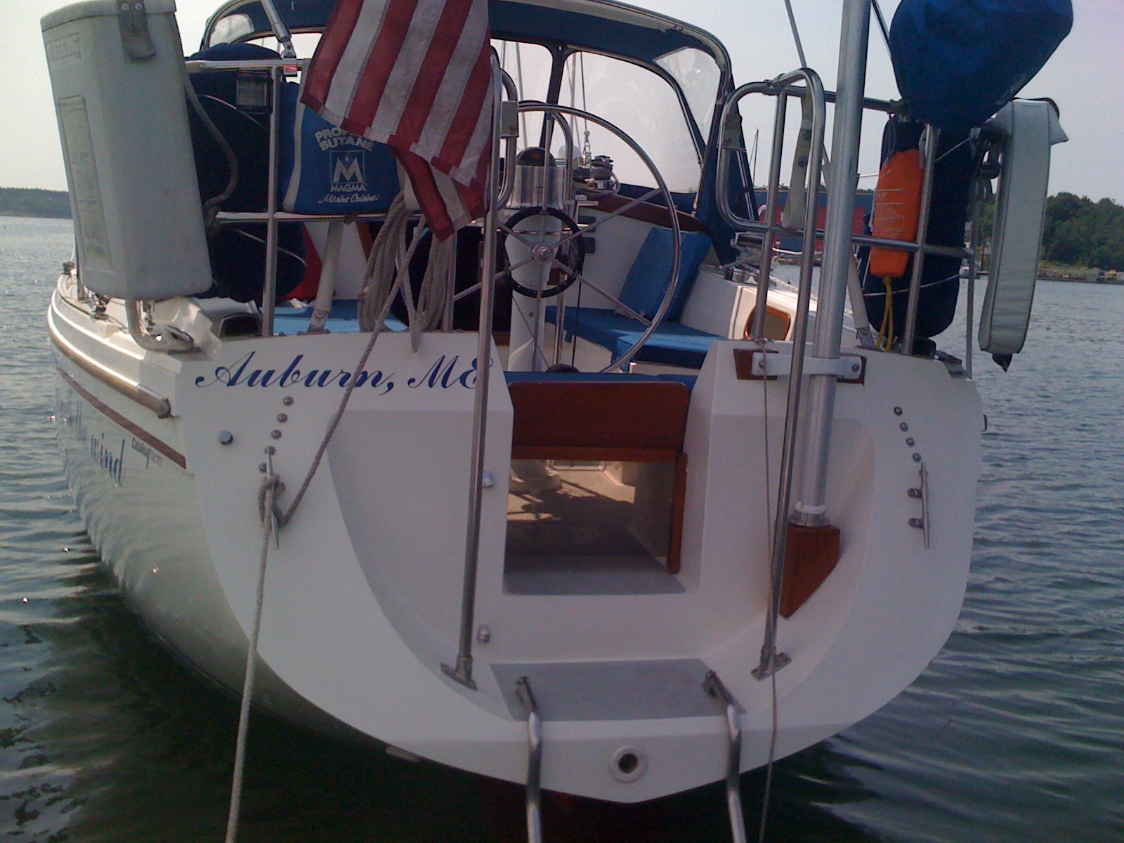

Hi all,
I don't know if any Mark I's were constructed with a split back stay but I wanted to see if any of the newer model mark ! every were fabricated that way.  I am considering splitting the back stay to allow easier access to the aft ladder and i would like to set up a chair in the center of the rear of the boat.  I know that Garhauer sell 11" chain plates that they had in inventory for the Mark II and i reviewed the Mark 2 manual and saw the offset from center for the chain plates but i don't know if it would be possible to mount the chain plates on a mark I because of the rubrail that is on the stern.  any thoughts would be helpful..

Hi Mike,
I have the MKl that is a MKll wannabe with the walkthru stern. It is a split backstay. My Catalina 30 was also (split) and it was a solid transom (no walkthru)  Note the chainplates enter the top and then thrubolted to the stern

thanks for the photo it looks  something like that should work although I would need do do something a bit different with the length since my rub rail extends all the way around the transom, maybe make the chain plate a bit longer and " skip" a through bolt where the rub rail is.

The split back stay installation on our MK I is the same as Gary's and we do not have the walk through transom. The chain plates are on the inside of the transom and do not interfere with the rub rail.
I suggest you go with the MK II back stay bridle as it is about 17 feet long with turnbuckles at the bottom of each leg for tensioning the back stay. The bridle on ours is only about 5 feet long and comes very close to my head when I stand at the helm.
When you install the chain plates, position them at the same angle as the legs of the bridle so there is a straight pull on them. Hope this helps.
