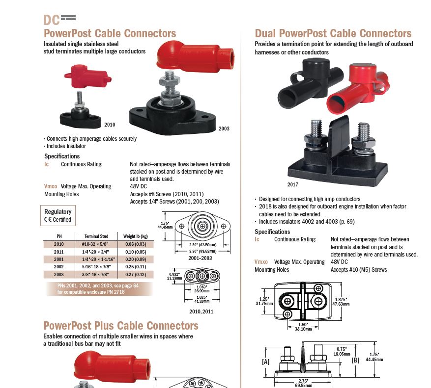

Continuous run of the proper size wire is always best but if your going to splice two wires to make the run  use one of these instead of a bolt to connect..
