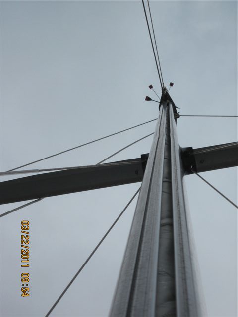

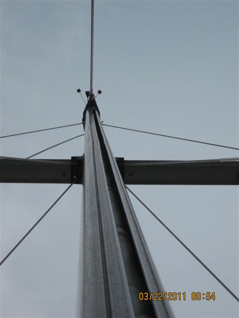

While doing a bottom job on our 2000 Mk II 36, the yard noticed "dimples" or indentations on either side of the sail track just below the spreaders. They sent me pictures and the damage is quite visible. The yard told me that a similar mast on a Catalina 36 had been "condemned" by Sparcraft.
Has anyone else had this problem and if so, how have they handled it? Looking for advice.

You should certainly get Sparcraft's assessment of the situation. If the structural integrity of the mast has been compromised you might dismast. Suggest not delaying talking to them as safety is of utmost importance.

Looks like it may have been damaged in transit or in the yard from improper lifting. Was it like this from day one?

The yard is dubious about the strength of the mast in San Francisco Bay winds having seen two masts with identical problems in one week. It is true that we routinely sail in 25-35 kts here. No reply from Sparcraft yet to my inquiry. Al Fricke

I don't have an in-mast furling main, but it looks like the back stay tension was too tight and/or the lower forward stay tension was too tight causing the mast to bow and "kink". I personally feel the mast for the in-mast furler on a C36 is too light for the job. just my 2 cents.

I noted a similar problem with the roller furling mast on my 2001 36 MKII at the start of last season- same place on the mast but not as pronounced. I was having difficulty getting the car that takes the head of the sail up the mast to run smoothly and, looking up the mast, discovered the kink. I took a little off the fitting with a dremel ... all better. Over the last two seasons the roller furler has become somewhat "stickey" and at times requires extra help when deploying the sail. I am now wondering if the two issues are related. Could this problem be more common with Charleston spars roller furling masts of this vintage? Is the intergity of my mast comprimised? Is this a design/engineering problem? I am looking forward to reading further posts on this matter.
